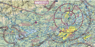

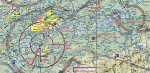

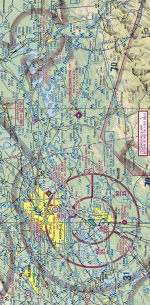

"Allow Alternate Orientations for Charts
  • Sectional charts can now be displayed in alternate orientations, previously limited to "North Up" only."
Great! Now the people that want their upside down text can stop complaining! 🤣 No wonder so many have no idea where they are at when they make radio calls on the CAF.
View attachment 62853View attachment 62851
Sounded good on paper. But I think i will stick with tried and true. As a old time RC airplane pilot, I can think backwards better than i can read upside down.
But I really like the IFR charts in the inset. very helpful.
Now only if we can have a scratch pad, so i don't have to use pen and paper to copy clearance. (or is it Clair?)
