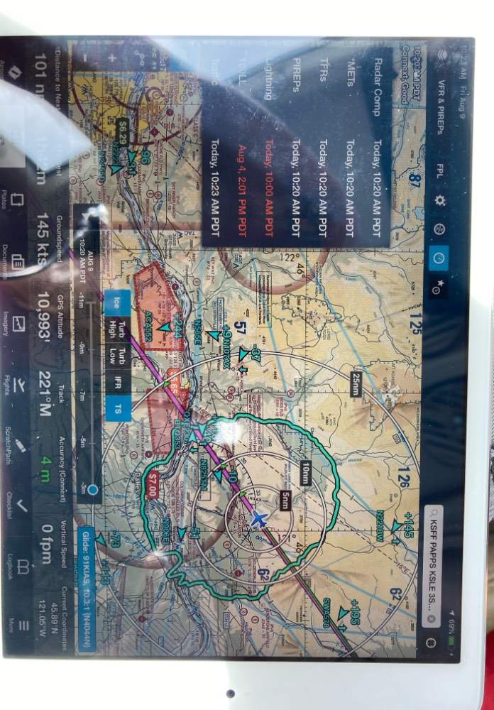

Be careful relying on foreflight also.
I busted a VIP TFR last summer because Foreflight didn't show the TFR. Yes, I'll put my hand up and admit that.
Neither foreflight nor my GRT system displayed it. I restarted foreflight (I think it updated) and it showed up. Luckily for me, I screen shotted the display without the TFR showing. Resulted in a couple of phone calls with the secret service and a NASA report.

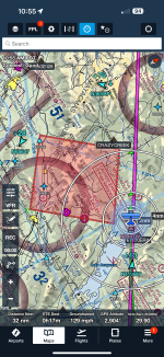

Went flying today. There is an active TFR to our East. I was going to the airport just North of it. I went to the weather page and selected TFR. Nothing on that page. I made sure TFR was selected in the airspace page. Nothing ever shows up on the G3x using a GDL50R using rs232.
Foreflight showed the TFR.
