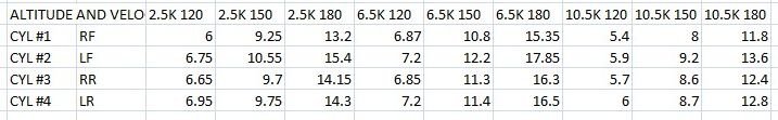

There are variations in local pressure at the four (or six) nozzle locations. We're all familiar with the idea that cylinders don't necessarily get the same cooling mass flow, and that's all about local pressure. I placed a bubble rock next to each nozzle and recorded some numbers a while back. Note that #2 was actually the highest local pressure.
Each bubble rock value is an average over a time period well in excess of a 720 degree cycle. Instantaneous pressure is highly variable, so deltaP across the nozzle bleed varies continuously during the cycle. I have those measurements too. Requires a fast differential pressure sensor and laptop recording.

... I placed a bubble rock next to each nozzle and recorded some numbers a while back. Note that #2 was actually the highest local pressure.
