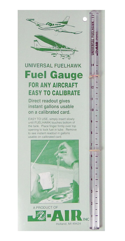

I have used this universal stick since day one on my 7a. I use it at the start of the day. You can create a calibration chart from 6 gallons all the way to full. I use it to set my fuel computer on my Advance Flight System 2500.
