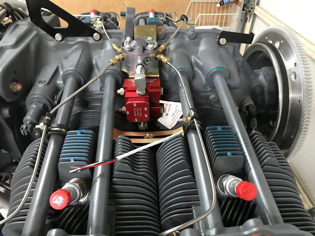

Does anyone have experience to share on the Aircraft Specialty FT-60 mount for injected engines?
I only know one, Jereme, who has installed it. I don't believe he is flying yet.

Larry, I'm currently working with Tom (TS) to get that bracket to fit the way I'd like it. He has been very patient with me and excellent to work with. Here are some of the things I've learned so far during the process:
  1. Make sure you specify Lycoming or AFP. The brackets are different. Guess what I didn't do.
  2. The Lycoming hose between the servo and fuel divider will be too long once the red cube is installed. Wait until it's mounted before you measure and get a new hose. If you guess like I did, you will get it wrong and go through several hoses.
  3. Using Tom's "v1" design, I found I needed about 1/8" of shim between the bracket and engine case. This necessitated a longer bolt. Spruce part # 08-07453 seems to be the right size for me, but I have not final installed it yet. Tom will likely weigh in on this thread to mention he has a new version of the bracket coming soon that will eliminate the need for shims, but I didn't want to wait.
  4. When mounted as in your picture, you may find the straight fitting on the inlet side of the red cube is a little far outboard, and comes very close to the cylinder fins. I plan to mitigate this with a 45 degree fitting from the red cube, plus a 45 degree hose end, to ensure clearance and a "straight shot" down through the intercylinder baffle hole. The right fitting would be AN823-4-4 (steel) which is impossible to find online. Tom can hook you up.
Remember to plug the "gauge" port on the fuel divider, per SB 18-05-21.

There are alot of ways to do this. We opted for the flow divider location to eliminate 2 hoses in the install. 1 of those typically was pretty short and a critical measuerment. If it was off, then the location of the transducer was off, which threw everything else off. LOL----I cant tell you how many we did with guys asking if we could cut 1/8-1/4 off the short hose to allow it to fit. With that, I took another look to see what we could do about making life easier.
NOT TO SAY that ours is the bible on how to do it---alot of your installs work just fine. We took recommendations from several respected sources and came up with our solution. And yes----its had multiple revisions. WE are always trying to improve it.
Tom

There isnt a right wrong location to install the FT60. Some work out better than others for plumbing, maintenance, etc.
AGAIN----we had asked EI 9 years ago, to give us a 'recommended' install location. "Nope, its experimental," was the reply. So with the help of Team AeroDynamix, whom we we sponsoring at the time, we tested 3 different install types and locations to see the feasibility of each one. After 2 airshow seasons and no issues, we determined that the FT60 (unlike the FloScan) didnt care how it was mounted, vertical or horizontal, angled adapters, or straights, angled hose ends or straights. It just worked. Also---inverted flight had NO AFFECT on the readings---so that told us that mounting with the wires up didnt make a difference. (If youre inverted the wires would be down anyway).
So for roughly 8 years, we worked with builders that located the cube in just about every location and position imaginable. In working with them, we found that locating the cube in most areas, required 2 hose assemblies. The hardest one was the low version, above the servo with a short inlet hose, and a longer outlet hose. Almost always the short hose was either too long or too short. So we worked out a way to eliminate the short hose by mounting the cube at the flow divider. It flew that way for 8 years, no mechanical issues or failures.
Enter Chris Hrabe that wanted a support bracket. Some of you may remember the threads. WE got some engineering help from Dan Horton on the original bracket for Chris, then created the billet version we currently have.
No disrespect to anyone, but there isnt a right way, but surely wrong ways to do it. And, for the fuel spray thing---YES certainly a bad situation. So is a loose fitting on the fuel pump, servo, or anywhere else in the system that could potentially spray fuel on a hot surface and cause a fire. And yes the engine probably would have fuel starvation and stop.
Is the Vans location on the RV14 (under the #4 cylinder) any better or worse? Is a firewall location better or worse? Is a cabin location like the RV10 better or worse? All have good points and not so good points, but ALL are compromises to acheive the same goal. WE just did it a different way.
AND YES, like most things, we are continuing to do revisions to this install to try an make it better. One last minor item---we were told by a European client that their aviation authority approved the flow divider location.
The acknowledged guru of mechanical injection liked it between the servo and flow divider, and testing showed that it didnt matter if it was mounted high or low. So for ease of assembly, we chose the high mount. Your location is a matter of preference.

The short answer, worse.
A stock RV-14A with the flow transducer mounted per Van’s FWF kit instructions worked either perfectly, or it just failed to ~14GPH reading no mater what the fuel flow (as in pulling the mixture all the way to cutout). On top of this the problem would only happen when climbing above ~5000’ or so.
Replacement sender, checks on top of checks, no improvement. We finally moved the sender to another location off the engine and the problem went away.
I hear rumor this was not the only RV that had this problem.
The SkyView EMS install instructions are specific on not mounting the sender on the engine.

Carl---thats good information. We know of a few cubes that had electrical failures in the RV14 location. Broken wire at the body of the cube, even though there was the factory heat shrink sealing.
The readings on some of these units on some planes is a frustrating mystery. Rare occurances, but we do have a client that had a previous firewall location install that was doing an injection upgrade. He got our flow divider install kit to move the FT60. His readings were NOT what he had previously as was expected. So we moved the cube to a location near the servo, and still didnt read like the orginal install, but did read like the flow divider install. So, he decided to do some testing, and we moved the cube to a location between the pump and the servo. It read CLOSER to the original install, but not exactly, but closer than either of the others. CHANGED the cube to a new one---NO DIFFERENCES---even installed it in the other locations, and it matched those readings.
Flow is flow, and it didnt make any sense to us, him or the guru that we contacted. I will say that in the 8+ years of putting it at the flow divider, there has been 100+ installs, and maybe 5 that had some erroneous readings. Unexplained. Several changed cubes and recalibrated and it read 'normal' whatever that was.
So all things that seem equal are sometimes not.
Tom

HI John---We extended the slot for acces to the center bolt, removed some material from the bottom, and raised the roof on the insde of the cavity for alittle extra clearance for the transducer. WE also fixed a minor mismatch angle issue where our bracket meshes with the original Lycoming 75009 bracket. (Apparently mine was bent alittle different or other wise NOT exactly the same as others. So we made a couple of shims to temporarily solve the issue, but have the CAD drawing fix to make it all fit fine now.
WE are going to do a 2nd production run, but in reality really would like to move the last ones we have of the 1st run. We also made a few minor tweeks to the AFP bracket version.
Tom

Without getting too deep into specifics, there are a few practical rules.
Keep hoses short and away from pipes. Long hoses are fuel heaters. Long hoses hear exhaust headpipes can be fuel boilers.
If engine mounted, keep the cube close to the crankshaft. Increasing the radius, crank axis to cube, means increased vibratory stress.
Mounting between the electric pump and the engine driven pump usually proves to be inaccurate with the electric pump running.
Tom's Flightlines setup with the cube in the servo-to-divider line nicely satisfies all criteria. No extra hose, mounted close to the crankcase, no pulse exposure.
Probably runs cooler, too.
