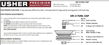

From insert that came with a fuel cap I bought from Vans a few years ago: “...lubricate both o—rings and all moving parts...A small rotation of 1/8” makes a large adjustment in the tension on the latch. Adjust the tension in the latch so that the latch just snaps over center. Do not overtighten! Cap is properly adjusted when it does not rotate when radial pressure is applied in the latch cut-out. A key or pen can be used for easy testing.”
I guess that’s where I read it. So, apparently the answer is to keep tightening the bottom plate — 1/8 turn at a time — just until “radial pressure” no longer causes it to rotate. And to buy some Krytox.

They need to be tight if you don't want water past them. If you can lift it easilly with a fingernail, I promise you that it WILL allow water in. My 6A sits outside and have replaced the pin several times; I know how tight it needs to be to prevent rain water from entering your tanks and it is well beyond just enough to stop rotation. Here is how it works: the lever is rotated 90* and this action pulls up on the shaft. The shaft is attached to the bottom piece fo the cap. As this bottom piece moves up, it forces the O-ring outward into the housing and also must compress the large O-ring. If there is not some effort required to open or close the lever, you are not getting much o-ring compression and therefore not getting a good seal. Lubrication of o-ring makes the force less.
If you are one of those with a plane in a hanger and wouldn't even consider flying somewhere if it could possibly rain, then it is just fine to tighten just enough so it doesn't rotate. Just BE SURE to sump the tanks if it does rain. Mine, when set with enough tension, can sit outside for years and never have a drop of water in the tanks. Once I was in a rush replacing a pin and didn't measure before replacement and set what I felt was pretty firm and started getting water in the tank. If you set them just past where they stop rotating, you will get a LOT of water.

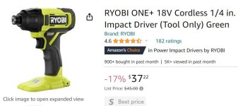

Use a 1/4" impact.... short bursts only. Hold the cap in a gloved hand to reduce the chance of hinge pin damage.
