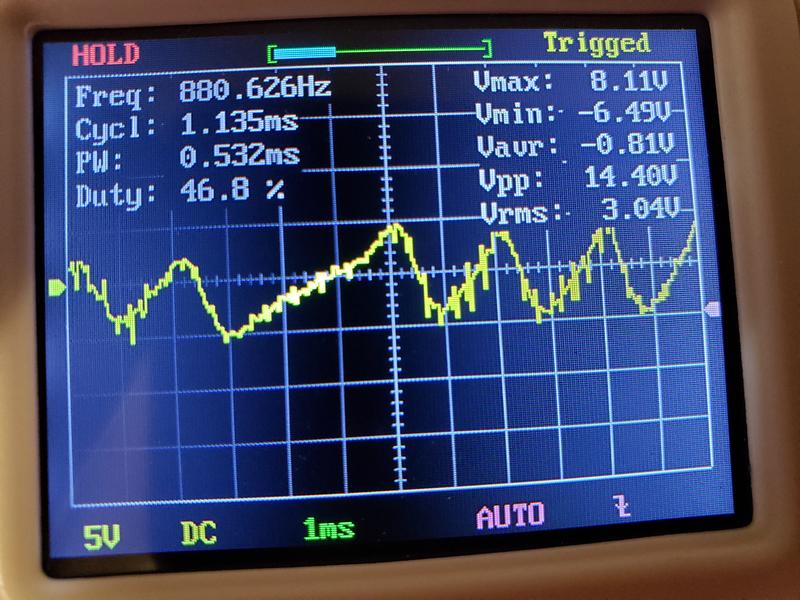

Dan, do you recall how you measure current?
Average, just a Fluke multimeter in series.
I?m guessing my setup is showing peak current snapshots.
Me too, but I have not put a scope on it.

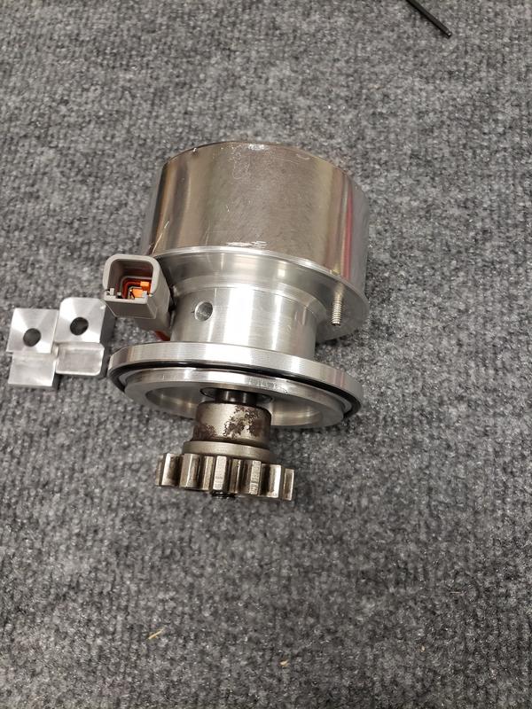

Dan, all good feedback. The spacer is a shaft collar, so it does retain the shaft.
Yes, the gear will have to be removed in order to remove the snap ring, but that shouldn't be a problem. The shaft has two existing holes from where the magnet was attached, I'm hopeful those will line up close enough to be used for the gear retention, but I missed one critical dimension when I pulled my mag to measure, so I don't know for sure yet.
Dan,
Do you happen to know either:
The distance from the shaft shoulder to the face of the mag drive gear, or the distance from the magneto-to-acc housing face to the shaft shoulder? I failed to get that measurement when I pulled my mag.

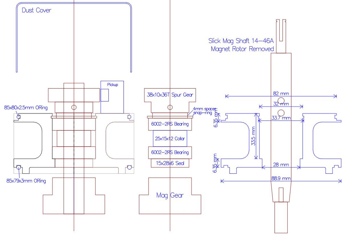

Not sure of what your mean by "shaft shoulder". Got a drawing for dummies?
The shoulder where the shaft taper transitions to the threaded portion for the mag drive gear. Basically I need to figure out the position of the mag drive gear on the shaft.
The sholder where the shaft taper transitions to the threaded portion for the mag drive gear. Basically I need to figure out the position of the mag drive gear on the shaft. Hoping to do so without pulling the mag again, but that may be what I have to do.

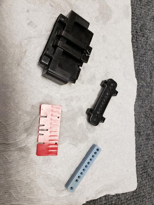

Be nice to have one that has NOT been pre wired like this one or a source for replacement female pins perhaps? Any Ideas?

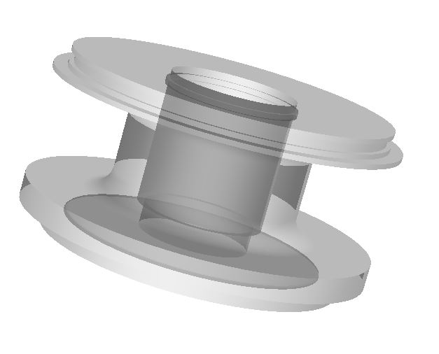

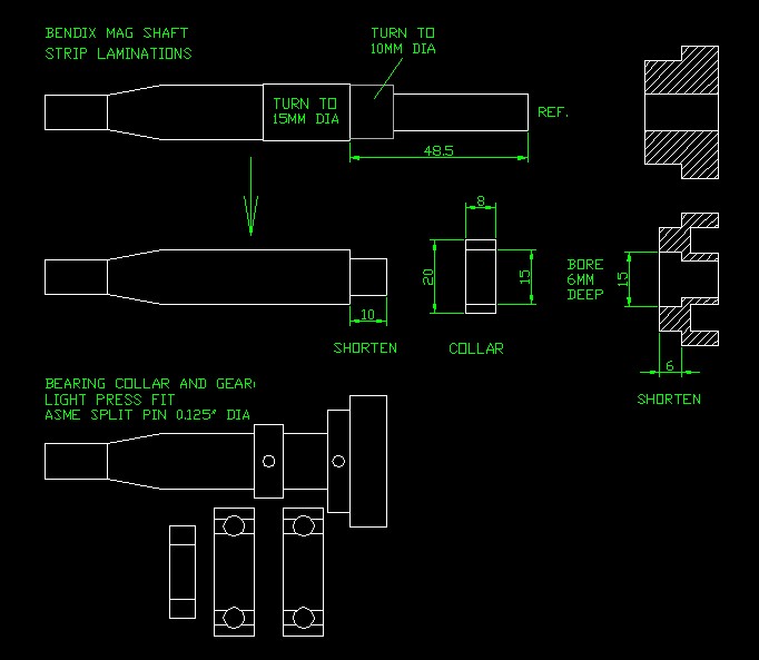

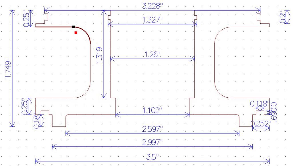

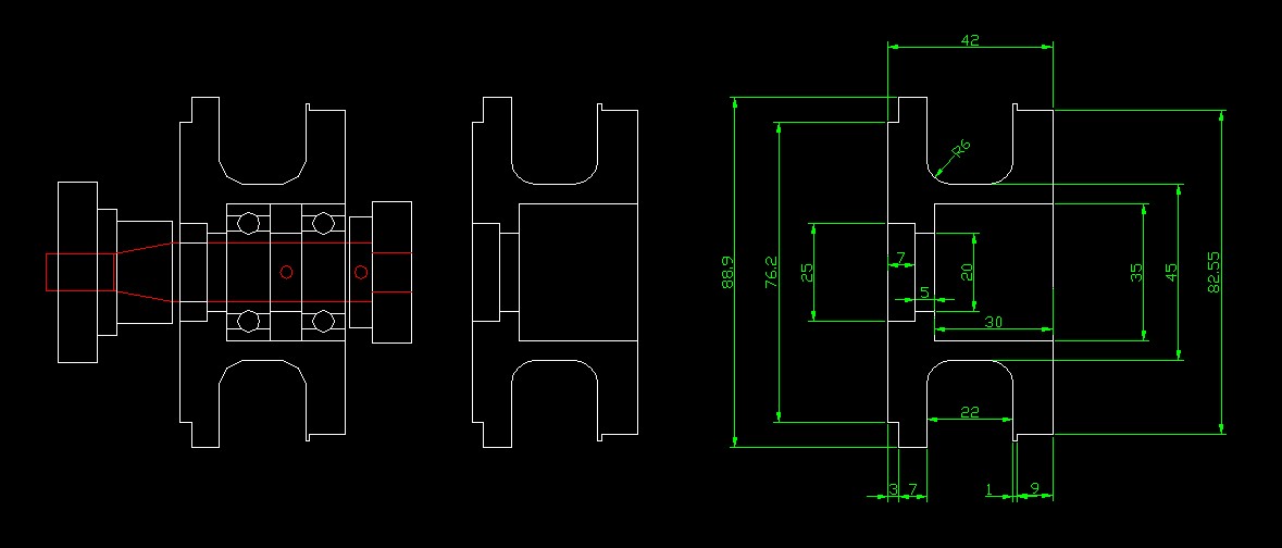

I'm happy to repost my drawing in inches. However, my setup is yet untested. Also, I made a few minor tweaks that aren't on the drawing. I made the o-ring grooves slightly deeper and made the engine-side bearing press fit and the aft bearing slip-fit.
Yes that would be great.
Would like a drawing of the shaft as well. I think it would be ok to make it out of 4140 or 8620 steel.
Bob,
Sorry for the delay. Here is my housing drawing in inches.
How are you attaching the gear to the shaft? Loctite 638 might be an option with interference fit, or is there still room for a grub screw? There must be a secure solution involving a minimum of machining. It looks like Dan may have used grub screws.
Interesting, so you have an O-ring seal at the top or is that grove for bearing retention?

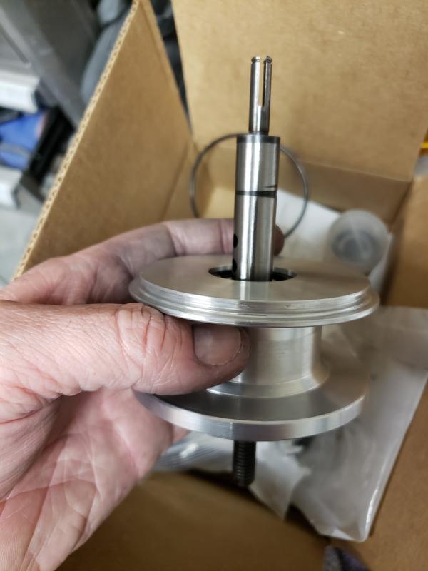

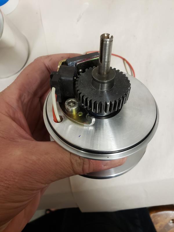

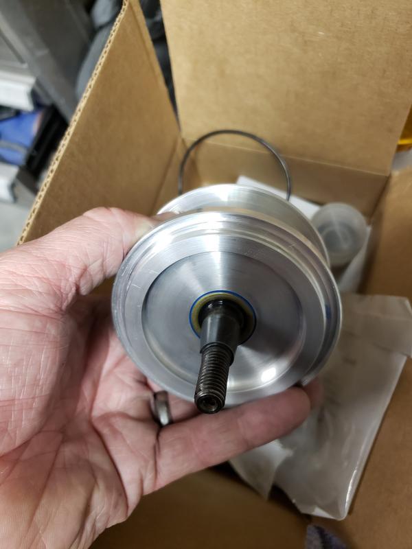

No grub screws for me. Both the trigger wheel and the bearing collar are a light press fit locked with ASME B18.8.2 split pins in double shear, 0.125"D.
The idea was to create a cartridge, a complete shaft assembly for insertion into the body. It is retained with a surface plate, rather than the internal snap ring chosen by Colin. An internal ring requires installing the trigger wheel after the fact.
Had a private note with a very good suggestion. The trigger body could have an oil weep hole to vent the bearing space. It would offer an early indication of oil seal failure. Although oil is unlikely to bother the magnetic pickup, oil washing is not good thing for sealed bearings.
Thanks for the updated diagram Dan. I'm wondering what your thoughts on detailing the bearings are? Figuring to reverse engineers something with some service history, I measured 0.002" interference fit on the outer race of a slick core (6002 40mm OD Bearing). Given the relative expansion rate of the aluminium housing, vibration and estimated operating temperature of ~100C that seems like a reasonable number to shoot for on the outer races.
One of the other vendors appears to use Loctite retaining compound to hold the bearings in their housings however I think that is pushing the friendship with an aluminium housing exposed to the heat of the engine bay.
The shaft measures 0.0003" over the inner race which would put it towards the tighter end of a js5 fit etc.

Do your research here. Bearings in these applications typically have one interference fit and the other with slip fit. I built a similar device and used interference on the shaft and .001 slip on the outer shell (recommendation from bearing company driven source gets interference). I did use wave washers on the bearing retainer to add a bit of tension on the bearing to prevent any spinning. Also a recommendation from the bearing engineers. Every alternator or similar device that I took apart was done the same.
I am told that two interference fits will take too much clearance from the ball/race interface and is a problem for high RPM applications.
