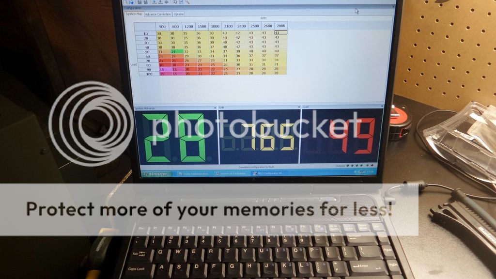

You have a 10 x 10 window of RPM and load to play with and the possibility to have 2 different map swithable on the fly.

And a picture of my ignition map while running the whole system spinning the trigger wheel with and holding the sensor in the toolpost on my lathe:
It seems to be very accurate with a timing light on the chuck and very tolerant to sensor to Wheel clearance, up to 1/4 inch no problem and no shift in timing.

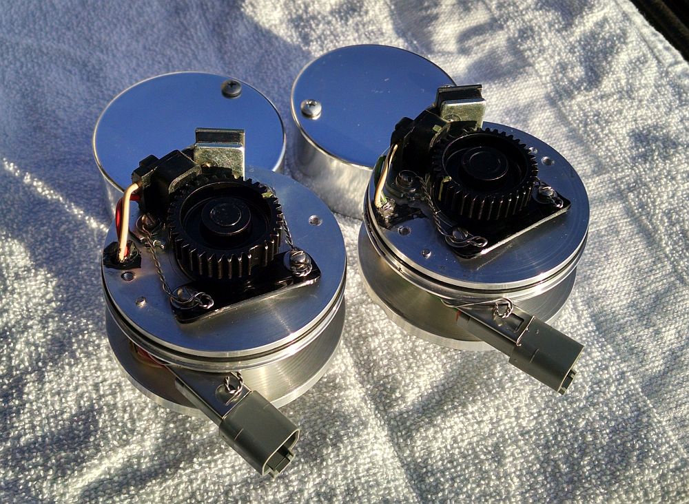

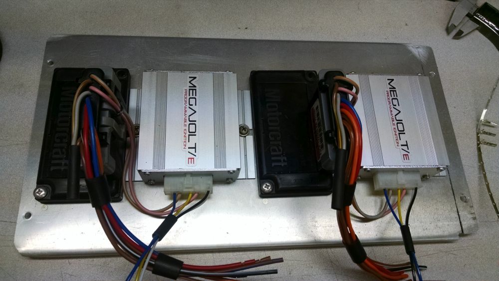

I built accessory case trigger assemblies:

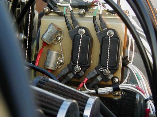

Motorcraft EDIS modules (black), Autosport Labs Megajolt/E timing controls (silver):

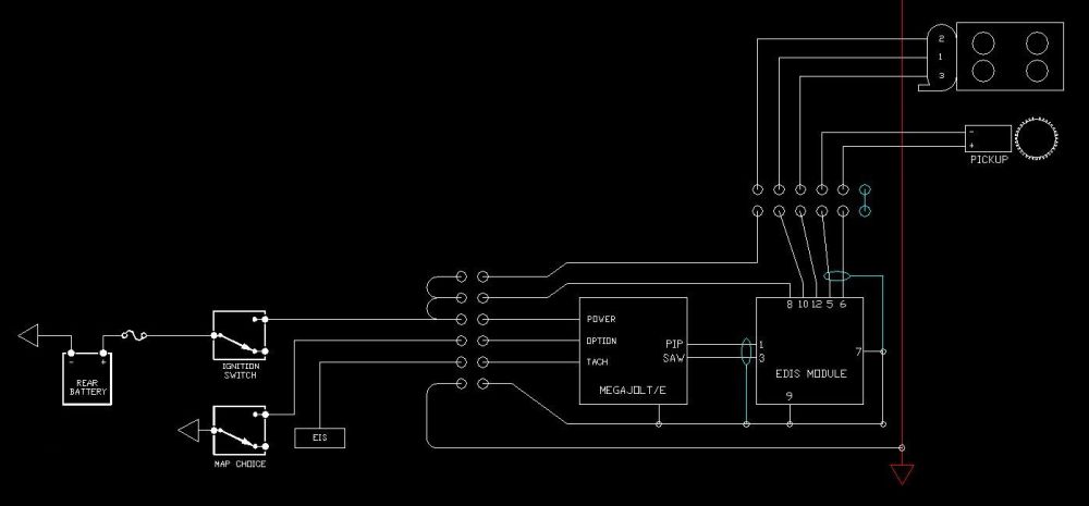

Wiring:

Autosport's Megajolt/E is EDIS only.

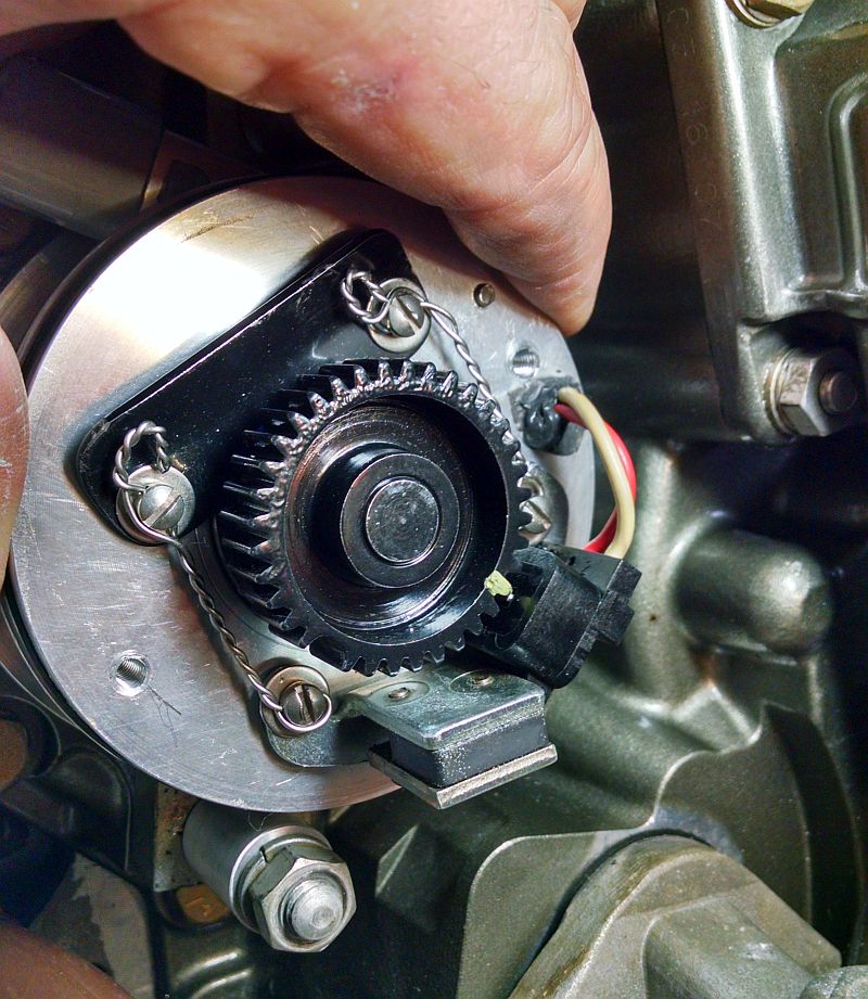

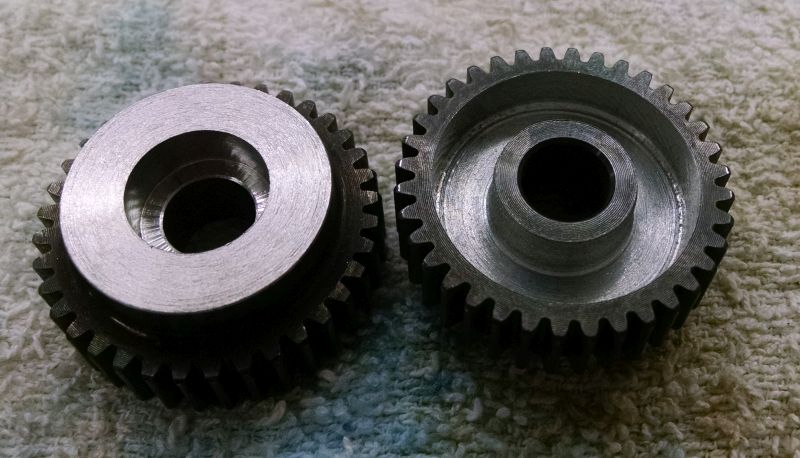

Bob, almost anything which provides 35 teeth and a skipped tooth space will work. The Lycoming flywheel has 12 AN4-sized mount points, so for a first pass, I drew this, and Kirk (that's Kirk Harrel, the Mustang II owner) turned it out on his mill. It's a steel plate, 3/16" thick IIRC, cut on a rotary table. It would be real easy to do on a waterjet; hand the operator a .dwg file and a few bucks. Flywheel = gray, trigger wheel = white. A standard Ford pickup points forward (at the sides of the teeth), much like the mount you've seen for hall effect triggers. Note small alternator pulley.

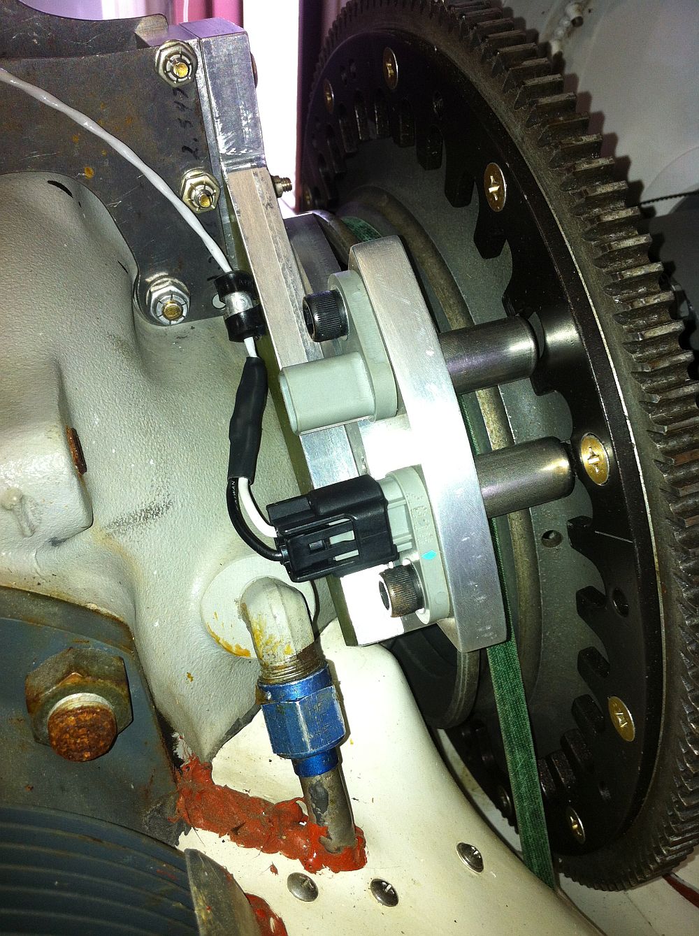

BTW, a little design tweaking would save weight, but for those who have rear CG concerns, well....
On Kirk's Mustang II:

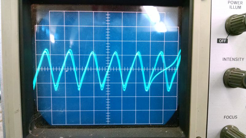

Make the tooth width the same as the width of the tip of the pickup; that nets a clean sine wave signal for the EDIS module. See the blip on the right? That's the passage of the skipped tooth.

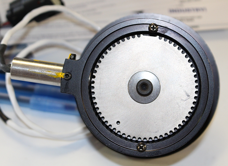

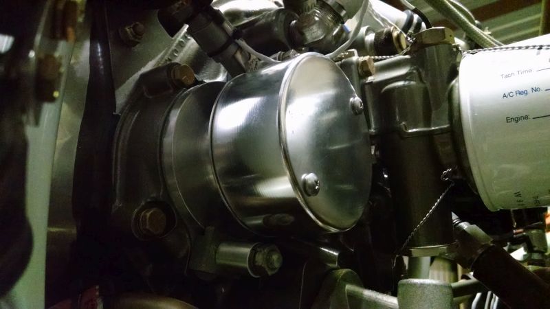

Lest anyone think the basic tech is unknown in airplanes, this is a Electroair mag hole trigger...60 teeth less 1, tubular magnetic pickup on left, which can be used with a 36-1 wheel also. It will be same output waveform as in the previous photos, and Electroair sells them in two sizes. Me? I like the ND pickups, reliable and very compact.
Dan;
I see 36-1 trigger wheels of different diameters for sale on fleabay, intended for the Megajolt market.
What is the diameter of the inside of the Electroair mag hole housing?
This looks like a cost effective and quick timing solution.
For what it's worth, the Ford Explorer 5.0 (aka 302) V-8 from 1996 to 2001 used EDIS, and had a 36-1 wheel on the harmonic balancer. Probably too small for a Lycoming flywheel though I haven't tried to measure. My experience is from automotive projects using Ford's EEC-IV EDIS.
Dan;
Not much on Ebay is going to fit the Electroair shaft. The easy way to adapt one to EDIS would be to simply re-machine the existing wheel, which is really a disk about 1/8" thick. Lop off the 59 teeth, cut 35, and slide the pickup inboard a wee bit.
The disk is clamped to the end of the shaft with one allen screw and Loctite. There is a tiny roll pin under the cap to safety rotation, but I'm not real impressed. The pickup just clamps in place with set screws.

....and this is the signal from a Nippondenso pickup, with a 36mm diameter wheel made from a cut-down gear...the shop-made mag hole trigger on the previous page:

Frankly, I like the OEM Ford module, as I figure it is far more hardened than any aftermarket control.

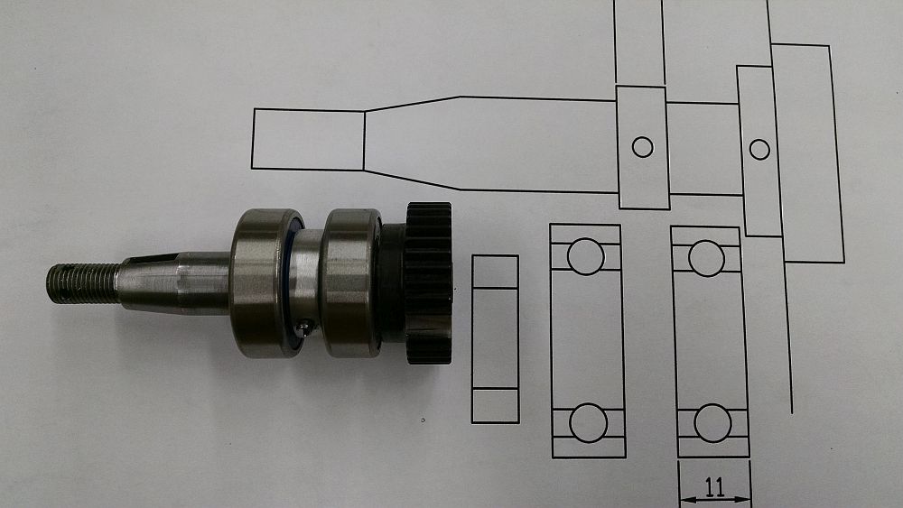

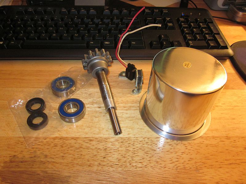

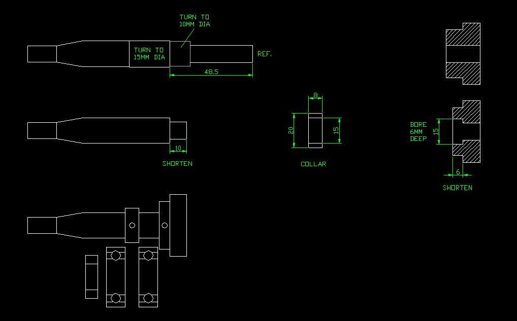

Speaking of reliability, the mag hole triggers do add some mechanical complexity to a reliability assessment. Bearing and shaft fits are examples; do them wrong and reliability suffers. I've also previously reported (in another thread) some possible resonant behavior at a mid teens RPM; the timing light goes a bit fuzzy there. Mags have the same problem, BTW, but we rarely observe it. I'm not worried, as the rotor is both robust and low mass, unlike a mag rotor and internal gearing.
The shaft is taken from a junk Bendix mag; the rotor leaves are removed and the shaft is re-machined. This approach makes it unnecessary to cut the taper, key slot, and threads for the drive gear.
The wheel is a re-cut stock gear. The body is cut from a chunk of 4" billet. Kirk did them while I was making the shaft assemblies, then I detailed them for bearing fit, o-ring groove, reluctor mounting, etc. The ND pickups came from an RX-7 distributor, which happens to have two of them. My favorite part? The pretty aluminum dust covers. They're cut-down cup holders intended for DIY poker tables.
No, I won't make more. As stated, I'm not going into the ignition business. You're welcome to drawings, in the spirit of open source.
The black bar "in front" of the gear is a bearing retainer. Correct?
Correct.
Is the electrical connector from the Mazda distributor also?
No, it's an Amphenol AT series connector, interchangeable with Deutsch DT series. I really like 'em. High overall quality, and the terminals crimp to the wires just like an oversize D-sub pin. Even the tool is the same, but in a larger size.
Are you sure about that? Some aftermarket stuff is certified, others have been third party tested for vibration, EMI/RFI tolerance for use in military UAV applications where expensive sensor payloads are at risk.
You're right of course. I should have said "far more hardened than any certified, military grade aftermarket control available for about $100 brand new".
Can't beat used OTS automotive hardware for the price point for sure.
With used, you could be fortunate that if it has lasted 10 years, it's going to last another 10 or 20 or unfortunate where a good portion of its life is already behind it...
Not all Ford electronics in the last decade have been great. The EDIS DOES have a good record in my experience and I especially approve of the ND pickups which are bulletproof in a fixed configuration- much more so than some other brands of OEM magnetic pickups which I consider unfit for aviation use unless you have two.

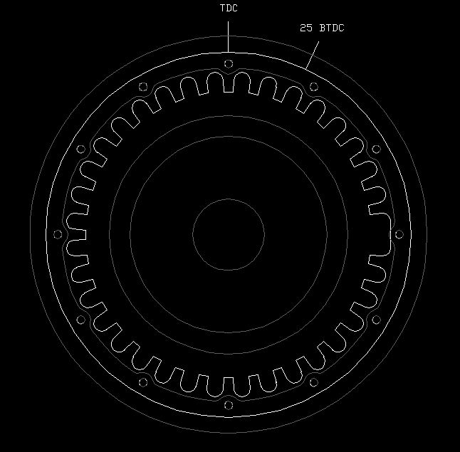

An accessory case trigger with an ND reluctor has an interesting property; the toothed wheel naturally positions itself with a tooth centered on the reluctor tip. After all, it a magnet.
In the photo you can see I've marked the 9th tooth after the skip with yellow paint. To install the unit into the accessory case, place the crank at TDC, align the painted tooth with the reluctor, and slip it into the accessory case while meshing the drive gear. When in and clamped, the painted tooth is inspected to see if it is still aligned with the reluctor tip. The process is much like installing a mag using a stop pin. If fact, I could drill this assembly for a Slick stop pin, and may yet do so. For now, allowing the magnet to hold shaft position works fine.

A dual crank-triggered EDIS system, like another other, require two pickups. With small Hall effect sensors and flywheel-mounted magnets, they are usually stacked along a radial, one outboard of the other. That approach is tricky with reluctors. One, the reluctors themselves are generally larger, so it is easy to run out of space. Two, the tooth width should match the width of the magnetic tip of the reluctor. That makes for interesting machining.
Look closely below. The second reluctor (currently not plugged in) is offset 1-1/2 teeth from the first reluctor, or 15 degrees.
The Ford EDIS module is hard-coded to provide fixed 10 BTDC timing above 400~500 RPM.
Kirk was very clever here. Combine the 15 degree offset and the 10 degree built in EDIS module advance, and he has a 25 degree advance. The result is a fixed timing electronic ignition without using a Megajolt controller...just a pickup, EDIS module, and coil pack.
Note that he can still incorporate a Megajolt and have variable timing on that second ignition if desired. All he needs to do is enter timing map values 15 degrees less than the desired values. For example, if 32 BTDC is desired at cruise MP and RPM, he would enter 17.
And yes, my friend Kirk is an experimenter.
http://www.experimentalairplane.com/kirk.html
Dan;
I like that idea.
I had considered a 2 mag pickup arrangement with a manual switch for TDC when starting, and 25 BTDC when running with a 10 degree retard for idle. No MegaJolt.
With Kirk's idea,you get both the start 'retard' and MegaJolt control, with a 25 BTDC fixed option if the MegJolt fails.
If this was powered by a Permanent Magnet alternator driven off the vacuum pad you would have total redundancy and modern control, finally exceeding the classic magneto in all regards? (except dead battery hand prop starting)
