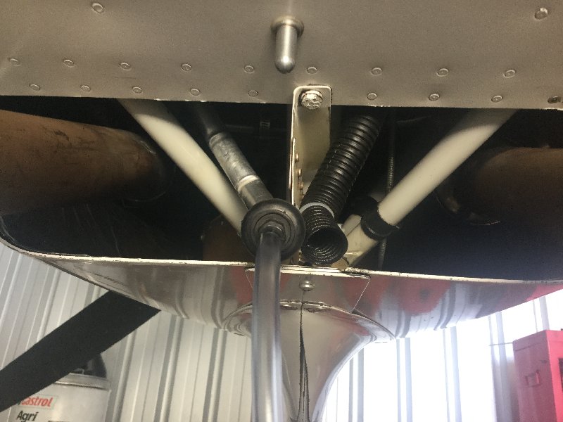

It's Dan's testing that caused me to think a lot harder about my FW penetrations, and make them better. In the end it cost very little additional time or money. Still far from perfect, and no idea if it will make any difference if I have a FWF fire, but I think they have to be better than a snap bushing with a bit of RTV.
Here's how I did it:
Wraps
Here's how I did it: ...
What is the shielding on the exhaust pipe?
What is the wrap on the Intake pipe? Silicone?
I may need to protect things as well.
My penetrations are very similar. Steel eyeballs and fire sleeve pathways.
I have similar radiant heat shields to protect the fuel lines and the control lines from the radiant heat generated by the exhaust pipes.
Thanks Mickey, I forgot about tubulars with a firesleeve wrap. Should have tested it with the others, but I suspect they will perform well, in particular if used in firewall locations which are not likely to be subjected to full fire intensity. The basic concept is that fire follows airflow, so locations near the outlet are likely to be a lot warmer than a location at the top of the firewall, as you pictured.
FWIW, I am also using a wrapped tubular pass though for the one penetration which carries a bunch of small wires. It's far over on the right side, out of the likely high temperature region. Used a wrapped fitting there so I can easily add and remove wires for my experiments. All the others are filled with FireBarrier 2000.
BTW, pick up some ordinary shiny aluminum tape, as used in modern residential ductwork. A reflective wrap on those throttle and mixture cables will significantly slow radiant heat transfer.

The exhaust pipes have "heat shield" on them to try to reduce the radiant heat that goes to things near the exhaust, like cables and hoses. I used both store-bought heat shield from Van's and "home made".
http://www.rv8.ch/heat-shield-home-made/
I don't have any wrap on my intake tubes but they have rubber joints that connect the tube to the "sump". I don't think these are silicone but some kind of rubber. I've got more pictures here: http://www.rv8.ch/engine-photos-after-test-flights/
I've updated the clamps there to "constant pressure" clamps. Just added some pics: http://www.rv8.ch/sds-intake-tubes/
@DanH - thanks for the tip on the aluminum tape - will have a look at that. So far I think the heat shield on the exhaust pipes is working pretty well, but I have not pulled the cowl in a good 20 hours - need to do that soon.
