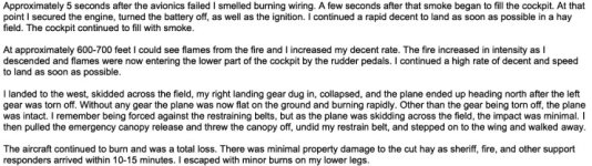

Oh, there's plenty of it, but again, it won't be listed as causal. Here's an example. Read the attached. This gentleman was a 1500 AGL over cut fields. Why were flames entering the lower part of the cockpit by the rudder pedals? Did anyone consider the question?

Dan - Your clip is merely a snippet from a pilot's post-accident interview. There is a lot of missing information that would be taken into consideration during the investigation to determine if the lower firewall did not sufficiently protect the cabin area. You have to consider ALL evidence gathered in an investigation. Beware of "Confirmation Bias".
Actually, from his NTSB Form 6120.1.
Yes indeed. That's the point. Where is the information? Did anyone at the NTSB bother to ask why a pilot was burned despite optimum conditions...a cruise altitude of 1500 AGL, with a mowed hay field on the nose, and a flight duration of not much more than one minute after first evidence of malfunction?
I previously asked you to define "protect". Here we had open flame in the cockpit in less than 30 seconds, while the certified standard (23.1191) is:
(g) Firewall materials and fittings must resist flame penetration for at least 15 minutes.
BTW, I interviewed the pilot. Ex-Marine. His written self-description of "minor burns on my lower legs" may have been overly modest.

As mentioned above, in 1999 there was an RV-8 that caught fire in flight. The pilot did get out, but unfortunately he was not wearing a chute. The NTSB said that the fire may have been so intense in the cockpit to be intolerable (the WWI scenario before chutes were widely used).
Here is the NTSB Final Report:
