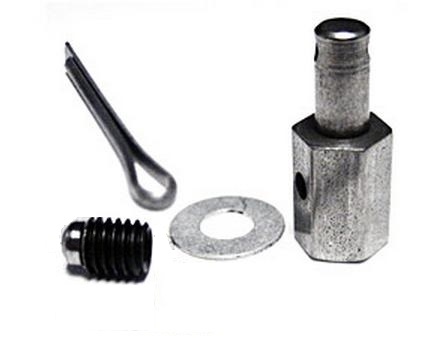

There are alternatives for the carb heat cable which allow the cable end to be tightened securely without affecting rotation:
Yes there are.
And over time with the influence of vibration (this is in a very high vibration area), and the above mentioned options only baring on the relatively thin metal arm, the hole will begin to wear and become enlarged. Once the wear starts it accelerates as the hole size grows.
The arm with the welded bushing has a large amount of contact area and doesn't wear.
