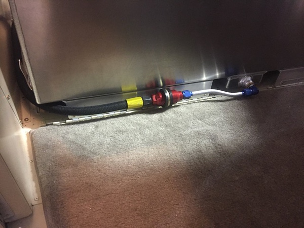

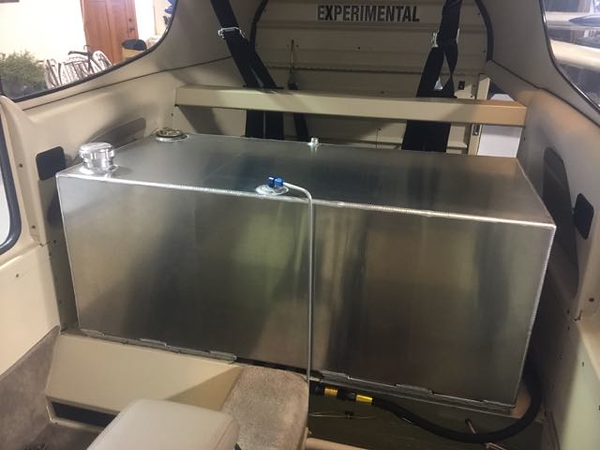

I've been planning a transatlantic trip to Ireland since I started building the -10. A tribute of sorts to the Irish who came before me to this great land in the knowledge that they would never return to the Emerald Isle. Anyways, here's my long-range tank installation. I designed the tank to hold 40 gallons and be easily installed and removed by one person. Fuel is plumbed into the 3rd port on the factory fuel valve. There's a small sump for the gravity feed, a finger strainer and an in-line fuel filter. A no-drip quick disconnect snaps into a fitting installed in the tunnel inside the area normally covered by the flap cover. The vent is similarly located through the tunnel and out the bottom of the fuse. A resistive sender connects to a spare channel the G3X and shows fuel level on the engine page alongside the main tanks.
The tank is secured to the rear seatback hinge and the outboard seatbelt anchors, as well as another hinge attachment, using extruded hinge, to the front edge of the seat pans. Fuel flow test results are similar to the wing tanks and flight testing shows no anomalies within the normal flight envelope. The tank weighs 43lbs with hose and fittings and the W&B station is the same as for rear passengers.
I love reading about guys with a plan to really travel. Best of luck on your planning and then your trip. Your tank looks nice!
Thats a great looking tank! Does it have internal slosh baffles, or are they even needed? Did you do the welding?
Wow, that really looks good! Seems like you've thought it out well and covered the safety aspects. So what will be your total endurance now?
The tank has 2 internal baffles. I had an expert do the welding - I only wish to be that good someday!
Economy cruise is 155ktas @ 8.5gal/hr at altitude. I'm running mags, so I can't get quite as lean as I'd like. Still, that yields about 10 hrs endurance accounting for climb to altitude of 12k or so.

Do you have the filler port inside the cabin? I think you?ll want some sort of vapor recovery nozzle/seal (like at car gas stations) to keep from filling the cabin with fumes.
Bob, I had the same concerns about uncontrolled fumes during fuelling, so much so that I invested a good deal of time figuring out a detachable extension to the filler neck to keep the operation outside the cabin. I abandoned that though after finding that a damp cloth held around the nozzle and filler neck did the job just fine, and I can take a peek in there as the level gets near the top, so it doesn't overflow.
Carl, the whole setup cost about $1k to fabricate. The welder isn't comfortable with referrals for aviation jobs, so I'll respect his wishes about that. However, I'm told there are a number of tank fabricators that'll make a custom tank to your specs for a variety of "off-road applications".
What's the possibility of using a Roto-molded, polyethylene plastic boat fuel tank vs having someone weld up an aluminum one from scratch? A 40 gal one from West Marine costs $220.
I looked into that as well as race car fuel cells, but I wasn't comfortable with being able to manage electrostatic discharge issues with polyethylene. There may well be a way to make it safe, I'm just not too familiar.

Bill, I did look at doubling up the wing tanks and have seen some very nicely executed examples of that approach by other builders. If the extra fuel is going to be needed on a regular basis, and the pilot is comfortable with the polar moment of the extra weight outboard in the wing, I think it's a good option. In my case, I know I'll seldom need that extra range, so being able to completely remove the tank seemed to fit the mission better.
