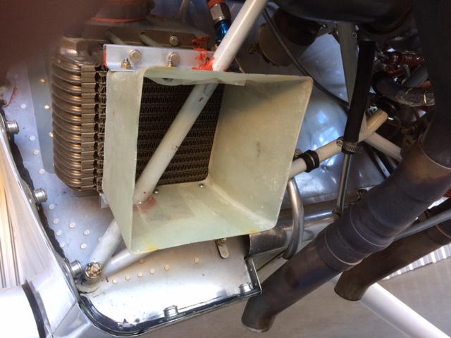

I want to do some cowl work to reduce my cooling exit flow area and at the same time reduce overall frontal area.
But before I can do that, I have to do two other things. One is make a seal around the crankshaft/spinner gap. As you close off the cooling exit, raising the pressure in the lower cowl plenum, you want the higher pressure to result in higher exit velocities out of the cooling exit, not just spill out around the spinner. So I have to do that.
The other thing I need to do is increase the flow through the oil cooler. The angle-valve engines put a lot more of the heat load into the oil, and efficient oil cooling is crucial. I've been very happy with my firewall-mounted cooler arrangement with the large 20006A cooler, I have good oil temperatures even during a long climb at Vy on a hot day. But as I close off the cowl exit and increase the pressure in the lower plenum, the oil cooler flow will decrease because of the reduced pressure differential across the oil cooler. So..how to get that flow back? put a diffuser on the cooler exit. The trick is to do this smoothly enough get good pressure recovery without a lot of length that wouldn't fit in the cowl area. Short, wide-angle diffusers can work pretty well. The pressure in the oil cooler flow at the exit of the diffuser will match the local static pressure in the area around it. Ideally, if the diffuser is flowing well, this results in lower pressure at the exit face of the cooler itself. Its like immersing the cooler in the throat of a venturi.

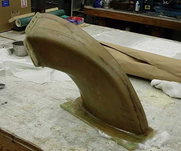

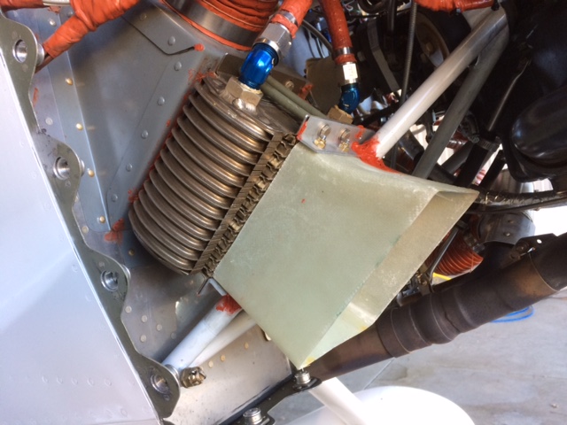

I made a mold out of wood, painted and waxed it, and laid up a fiberglass diffuser. The diffuser geometry has an area ratio of 1.45. This will also be a good trial of the high-temperature hardener system (3136R) I got for the Jeffco 3107 (Rhino) epoxy we use. The diffuser was room temperature cured, then removed from the mold and post-cured, 1/2 hr at 150F, 1/2 hr at 175F, then 2 hr at 200F. Hopefully this will give a high enough glass-transition temperature (T_g) for the epoxy to survive the hot environment in the lower cowl. Here are a couple of pictures of the installation:
You can see, especially in the second picture, that I made the diffuser a little bit too small. I had measured the mounting flange length and assumed that the cooling channels were the same length, when they actually extend about a 1/4" beyond. So I will add a 1/2" plank on the mold and make another one. In the mean time, I can test this one.
Another issue is that I have an engine mount tube crossing the exit face of the oil cooler. Without the diffuser, this likely reduced the flow through the cooler a little because of the "blockage". With the diffuser, there is some suction pulling on the exit of the cooler that will help pull flow around that tube. Hard to say if the unsteady flow around the tube will help or harm the flow in the diffuser itself. It may cause an oscillating flow separation on the diffuser walls, but hopefully the average pressure recovery will be OK. When/if I put a slightly wider diffuser on, I will also put a spiral wrap of wire on the tube to break up the coherence of the oscillating separated flow downstream of the tube. I'll report back when I get a chance to fly with this.
Based on nothing more than wrapping a cord around the roof rack bar on my truck, a single wrap or maybe a 1.5 turn wrap is sufficient.
The truck goes generally less than 75 mph, the bar is about an inch diameter, and the cord was 1/4" marine line. I expect the portion of the bar between supports was four to five feet long. The bar was close to the truck roof, relatively, several inches apart, and the effectiveness of the wrap was evaluated by the presence or absence of thrumming - oscillating aero forces coupling with natural frequencies of the roof, when there was nothing attached to the bar.
Dave
....Another issue is that I have an engine mount tube crossing the exit face of the oil cooler. ....
Could get Mr. 3-d Printer (AKA Steve Melton) to make a snap-on airfoil shape to go over the tube (shaped similarly to "streamline tubing" that we make pitot tube mounting extensions from).
Put an airfoil-shaped fairing on the engine mount tube to cut its drag. The engine mount tube doesn't care at all but the airstream does.
Thats a pretty good idea!
Thanks. Thats a pretty good idea. It would actually help with the diffusion too.
CFD plots I have for a 6A show essentially the same pressure at the spinner base as the the cooling inlets. My OAT sensor is placed just inside the spinner gap area and reads ambient temps any time I'm flying, proving that air is flowing from outside to inside. I use this air to cool my redrive case as it comes in nicely from all directions. You could instrument the gap and your inlets with a couple of piccolo tubes and Magnehelic pressure gauges to confirm.
I'd also instrument the oil cooler exit as it is now with a pitot tube to look at the present exit velocity before you spend a lot of time making a diffuser. You may find it is going very slowly after traveling down the SCAT hose, the wedge duct and through the thick cooler.
My guess after doing a lot of this through flight testing and velocity/ pressure measurement- you won't see any measurable gain in speed with this effort but would be interesting to see the numbers in any case.
I doubt if the tube will hurt much in the slow airstream there, most of the momentum loss is upstream of that and you have lots more area at that point too.

Ross, it is a gross simplification to state one pressure for the spinner gap. If you go back and look at your CFD results, you should see that the pressure along the bottom of the spinner where it fits against the lower cowl is well above free stream, almost stagnation. In that area, I would expect slight flow into the lower cowl from the outside. (I don't really want that -- it reduces cooling mass flow for a given lower cowl plenum pressure). If you look at the area along the top of the spinner, where the cowl lines are faired nicely with the spinner, you should see that the pressure there is lower than free stream. Air is spilling out of the spinner gap there. If you raise the lower cowl pressure, it will spill worse. ( I don't want that). The pressure at the spinner gap adjacent to the cooling inlets is part way in between the upper and lower -- And for most of us, the inlets are spilling out there too, so the flow and pressures right there are complicated. Flow likely going into lower cowl from outside. I don't want that.
The aluminum wedge-shaped plenum that mounts the cooler to the firewall is almost at upper plenum pressure, close to stagnation. There is some loss through the SCAT tube. I will likely increase the scat tube diameter too. Whatever speed the flow is through the cooler now, its going to be faster with the diffuser.
A lot of time? Gosh, it took about 4 hours total. I figured before I spend a lot of time acquiring and installing any measurement system, and even more time getting measurments, I would just go ahead and make one and see what the oil temps look like.

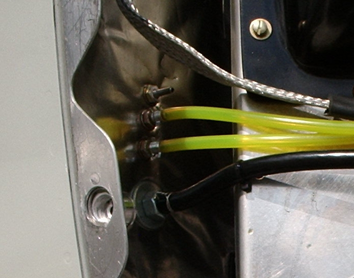

FWIW, I have a row of miniature bulkhead fittings installed in my firewall. Buy a length of 10-32 threaded rod. Cut it into 1-1/2" lengths. Chuck it in the lathe and machine a half inch of threads off each end, leaving a half inch of threads in the middle. Center bore with something small. Now drill a 3/16" hole in the firewall and fasten with a plain nut on each side. 1/8" tubing pushes over the threadless ends.

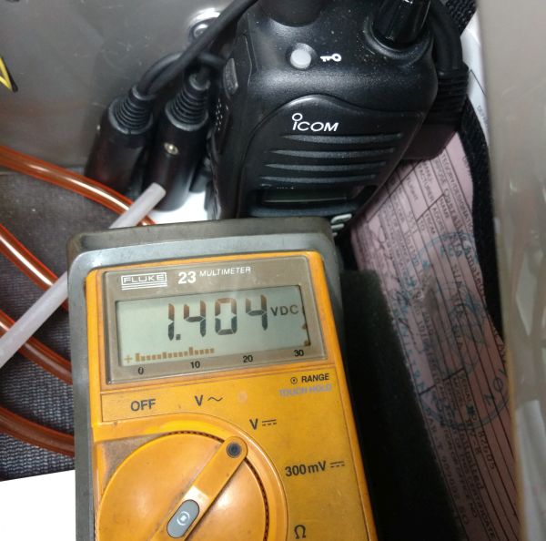

Easy temperature probes are LM34-ND top hat cans soldered on the end of a shielded 3-wire cable. The shield is purely physical armor, no electrical value, since the result is a tiny temperature probe on a wire you can move anywhere in the engine compartment.
The nice thing about an LM34 is the 10mV per degree F output. For example, 1.45 V = 145 F.
http://www.ti.com/lit/ds/symlink/lm34.pdf
All you need is power, ground, and your digital voltmeter. Or you can grab a handful of these:

Mini bulkhead fittings for manometer tubing, tygon small engine fuel line from NAPA:

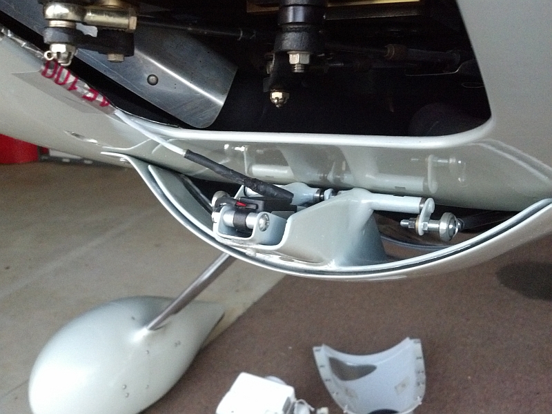

LM34 on a wire, here determining the air temperature near the variable exit servo:
Trusty Fluke in the cockpit. LM34 10 mV per degree means 140.4 F. Orange tubing is for manometer:

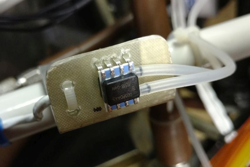

Just finished installing a single differential pressure sensor, but not for ease of use or less installation time (frankly both are worse), but because I want to look at intake tract and injector bleed pressures at 2400 RPM. In other words, I need a very high sample rate. So, I hope to do it with a laptop, a Dataq DI-1100, and somebody to manage it in the back seat.

Hey Steve, the inlet "diffuser" to that cooler looks pretty square, any chance some pressure/flow gains available there?
Off topic: maybe DR could/should make a topic category for "Data Acquisition" or "Instrumentation" or such, to capture specific ways we all gather data. Pressure, temperature, and frequency. It would be great to get all those ideas on one section. For instance: I use a 4 channel, stand alone, thermocouple data logger just to avoid the extra ancillary equipment of the DatQ box. The DatQ boxes are much more versatile. Also, the clever/compact little pressure sensor DanH had is likely one of many things we could use. Data is sorta easy to obtain, cost effectivity and accurate is another matter.
...Off topic: maybe DR could/should make a topic category for "Data Acquisition" or "Instrumentation" or such, to capture specific ways we all gather data. Pressure, temperature, and frequency. It would be great to get all those ideas on one section...
I support this too. In fact I have pushed for and received verbal agreement to start a "DT/OT" (Developmental test/operational test) on another forum. Each thread will document an idea from concept, fabrication, test and conclusion. It's intended to become a repository for ideas that are validated or disproved via the scientific method.
Not sure we have enough interest here in the overall VAF group, but I'd sure like to see it.
In hindsight, you are probably right. At the time, my thinking was that the velocity coming into the plenum box thru the SCAT hose is rather low, and so any loss is very small. However, I also used 3.5" SCAT, mainly because the butterfly valve fit on the rear cooling baffle better, but also because the slightly smaller hose fit through the engine mount tubes better. When I add up the effective flow area inside the cooler, through all the fins, etc., I find that the area is not much smaller than the flow area in the 3.5" SCAT. So I probably have more velocity, and more loss there than I originally imagined.
That being said, If I had used one of the commonly used fiberglass adapters that form a blended, but very short, wide-angle diffuser, with the moderate velocities involved it probably would also separate and cause just about the same loss.
I'm thinking pretty strongly about increasing to 4" SCAT. But since Ross and Dan implored me to take some measurements, I will measure what I have first, then see how much it changes with bigger SCAT.
If I had it all to do over I would probably mount the cooler perpendicular to the firewall with a mount that also forms the exit diffuser, and then make a smooth inlet adapter as well. Pretty hard to do that now on the finished airplane. But if the engine ever comes off.....
