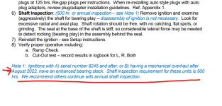

I dug into the four cylinder pMags bearing issue. What I found:
- The fixed rate $550 overhaul price tag was set by eMag before Hartzell bought them.
- The bearing fix is to swap out the alternator shaft and housing to accommodate the larger bore for the rear bearing, which has been done on all overhauls since 2022 and new production mags since serial # 8245.
- There is limited data on number of bearing failures at eMag. I can report 670 hours on dual pMags on the RV-8, and 1200 hours on an old set of pMags on the RV-8A. The RV-8 pMags continue to check good, and on the RV-8A one pMag failed the last Condition inspection on gear shaft wobble.

Says they've been doing the upgraded bearing since 2022 in the manual on Emag website
