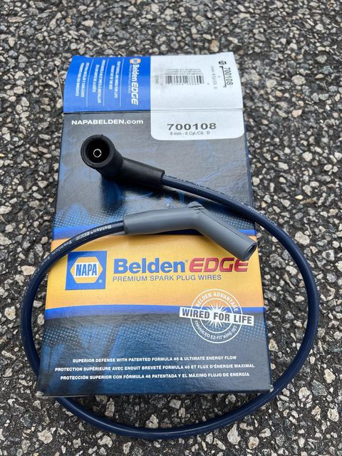

I have replaced at least 4 plug wire ends because they have come off the plug. I find the black clip on the metal terminal broke in half. These wires/ crimp ends are junk. Is anyone using some other brand of wires. This is really been a problem.

A little bit of sleuthing with my friends at NAPA came up with wires that worked for my installation. If I recall, it was a set for an eight cylinder which gave me many options to get the correct length wires.
I still have the leftovers, and will get you a part number when I get to the hangar in a couple days.
I misremembered, they were for a six cylinder Ford Taurus (2001-2007).
NAPA p/n 700108
