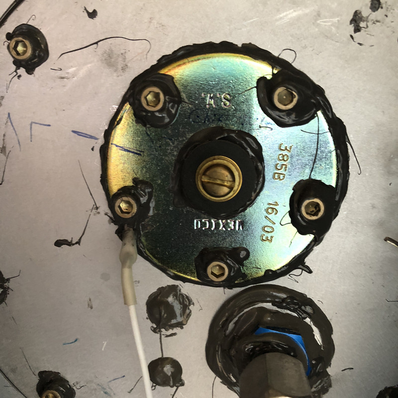

Here is a photo of my RV-8 left wing tank sending unit ground.

My RV-6 has been flying over 20-year with the same setup I am using on my RV-8 build.

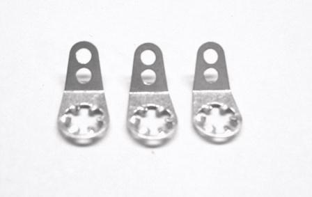

The ground wire is on a lug like this one. Yes there is good electrical contact using an ohm meter.

Nicely done.
Note that Gary's solder lug installation is also environmentally stable. Long term, it is unlikely to add resistance due to any reasonable level of corrosion.

Also, those toothed lugs are cool - where does one get those?
