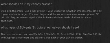

Tech speak for you guys in NA (yep, that’s for North America), a more popular glue would be the Weld-On 3, which I understand is much more of a liquid, and therefore to be applied in multiple layers.
Airplane Plastics, manufacturers of our canopies, offers some advice too, see https://www.airplaneplastics.com/faq
