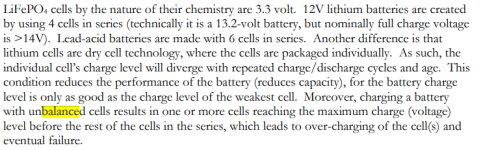

If this what you are asking about? The BMS can charge a battery cell by cell to insure one cell is not overcharged leaving other cells undercharged. Both will damage the longevity of a LiFePo4 battery.
From Earth X:
All types of lithium batteries (not just ours) require a “BMS” that monitors and balances the cell charge and protect from over discharge or over charge.
The BMS reset functionality of the Optimate is well documented, I was referring more to the cell balancing that you mentioned. Would like to know more about that.

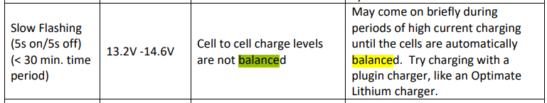

From the same manual's chart on LED light actions:

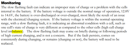

From page 6:
From page 2:
From page 5:
