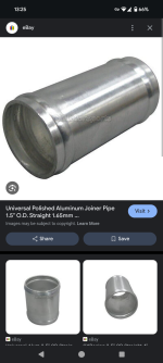

I'd machine new rings with a retention bead.
EDIT...thinking about it. Could you add retention "pegs" to the aluminum ring merely by setting a few 470 rivets spaced around the perimeter? Put the dome heads on the outside. Countersink the inside. Use a short rivet length and set the shop heads in the countersinks.
On the plenum side, it would be easy to add a bead. Sand 80 grit, tie a length of ordinary mason's string around the inlet tube, and saturate with epoxy.
Another idea for ‘pegs’. Install some LP4-4 rivets from the inside- out with some thin 1/8” washers on the outside to secure them. Corresponding holes in the seal.
