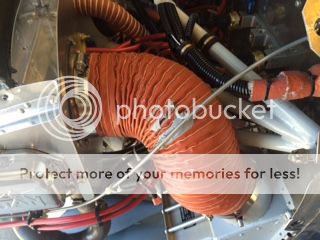

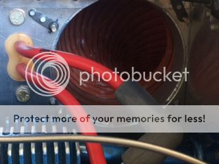

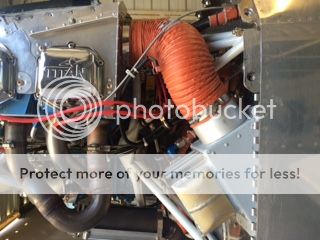

I will include a few photos of my oil cooler setup here in case anyone can spot a problem or a way to improve on what I have done.
Can anyone report on changing away from this setup, which I think is fairly common or at least I though it was, and seeing an improvement by going to something else, and what that change involved?
Like the previous post mentions, perhaps to many changes in air direction to be effective?
I will measure pressure differential on this setup and then after some more research, implement a change, based on what I learn from the pressure measurement.
An easy change is to go with SKEET rather than SCAT to see if that puts more air across the cooler. I think the net effect of going with the smooth bore SKEET is that it will act as if the duct is larger, maybe that will help.
I hate the idea of giving up on this high dollar oil cooler. So much for monkey see monkey do approach:)
The pressure differential across the cooler drives the lbm/hr airflow. Changing to SKEET will have little, if any affect.
If you really are against getting the right size cooler, then try mounting the current cooler horizontally. You might gain a few lbm/hr increase in airflow.
