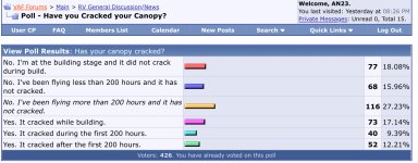

We are hearing a lot about cracked canopies, but not much from people that have not (yet?) had a cracked canopy. Is this an example of failure bias where we focus on the things that failed, not on those that succeeded?
When I go to Oshkosh and look at the 100s of RV-8 canopies, I certainly remember those that had a crack. My recollection is that it's way down in the single digit percentages, but I could be mis-remembering, and perhaps those with a crack chose not to display their aircraft at the big show. ¯\_(ツ)_/¯
A recent poll on cracked canopies. This certainly shows the problem is much greater than a single digit issue!
