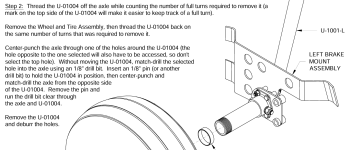

Tire, tube, and brakes worked on by a very experienced mechanic. He was unable to get the cotter pin through the pictured part, said to gently bend the pin, get it mostly though, then finesse through the final holes. He said not to hammer as it would bend the pin. So for now the cotter pin is through just the axle. Note: wheel pants off for a while now. I’ve been told to get the pictured part installed with a good cotter pin prior to flying.
Does this part keep the wheel on in some fashion or is it just for attaching the wheel pants?
Does anyone have the cotter pin part number or exact dimensions for me to order? I need to overnight it due to scheduling hence am asking instead of spending hours searching old responses.
Any tips or tricks to get the pin installed?
I might visit big box hardware store also.
Picture attached might show one hole through IS bore larger.
RV 10, stock.

The nut holds the wheel on the axle. It absolutely must be in place and secured with a pin. It also applies a small preload onto the bearings, so needs to be on at close to the correct torque (barely finger snug). In a pinch, a steel pin acquired from an auto parts store would be OK temporarily. Take the original one in and get the same size.
But if all this is foreign to you, you might want to get an A&P to do it.

That is the wheel retention nut. it keeps the wheel on, but also doubles as the attach point for the wheel pant. The "big" part of the nut is tightened snug on the axle, then backed off until the cotter pin goes through the axle and nut. You DO NOT torque that big nut down tight, or you'll burn up the wheel bearings. The small bolt holds the wheel pant on.

MS24665-379 or 360 (2.5 and 2.0 in) will work (ACS) or 3.2 by 71 mm. It's needed. I've seen some oblong out the hole slightly to get it in. (A new one is straighter and easier to install) Note: MS24665 seems to use cadmium steel or stainless steel. Available in both at ACS.

The cotter pin alignment issue is a common one. The cotter pin hole is drilled through the externally threaded axle. To insure hole alignment with the nut, folks drill the axle through the hole in the nut on one side, then the other. This often leads to the holes being slightly out of alignment, or slightly out of parallel to each other, hence the need to bend the cotter pin to get it through.

It was an AP/ia builder that could not get it on.
The bending was described as being because the edge of the rim blocks the pin from lining up with the hole.
Be sure the AP understands that there should be a bit of preloading of the wheel bearings. Most small aircraft wheels get the nut snugged then backed off slightly. Not on Matco.

Thank you, ordered.

Just open the cotter pin holes in the axle nut to the next drill size up, or big enough to get the pin through easily. Remember the pin hole in the axle was originally drilled by hand, so probably not perfectly aligned to the holes in the nut. I had to open the holes on my old Matco axle nuts after a few years of use. As far as adjusting the bearings to some preload; consider that the nut has to rotate 60 deg in or out to use a different hole pair, so you're going to get what you get with this airplane.
FYI, Beringer wheels happen to come with axle nuts which have ~3/16" cotter pin holes in them, so bigger holes won't hurt a thing.

That is definitely the way I do most cotter pins (there are several acceptable methods), but it won’t work in the case of the RV-10 axle bolt becasue the support strut for the wheel pant is in the way. This post just confuses the person sign the question because it doesn’t apply!

With some pliers, bend the cotter pin near the head. You should have a long straight piece left, that is long enough to go thru both holes, while the bend is sufficient so the head doesn’t hit the rim. Make sure the tail (end with two halves) doesn’t spread at all. Once thru both holes, straighten the head, insert the rest of the way in.
