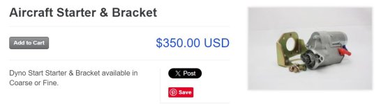

That is a 9 tooth starter. You should use an 11 tooth with the 149 ring.
Or just buy this.....
