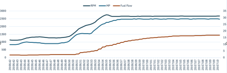

Is engine monitor data useful for evaluating the prop adjustment? Looking at the EDM data which is captured in 4 fractions of a second, I see the prop increase to above 2700 very quickly for a second then settles down to 2650 for the remainder of the ground roll. The aircraft is a -9A with a O-360, Hartzell prop and MT governor. Here is what the RPM graph looks like with 3 takeoffs and landings around the pattern.

Yes, it can be useful, though you'll want to zoom in a bit closer. What you've shown would tend to indicate that the low pitch stop is set low, and you're getting an overshoot before the governor catches it. The amount of overshoot will vary based on throttle application rate, and how low the stop is set.
A well set low pitch stop for an NA engine would tend to show max rpm less than governing, and a trend of increasing rpm with airspeed increase until reaching governing RPM.

Looks like you can’t maintain 2700 rpm in the climb? Raise your governor setting be backing out the screw on the governor.. and adjusting the cable so the blue knob isn’t bottoming on the panel before the governor hits the stop. Then to get rid of the surge, adjust the propellor low pitch stops to provide 2650 static. If you can’t maintain 2700 in the climb, you are not using the full 180 hp..

Thanks for the feedback. Here is the data zoomed to 28 seconds of the takeoff role and climb. The RPM is on the left vertical axis and MP and fuel flow is on the right. It does look like the prop is overshooting and stays at 2670 in climb.

If you can’t dial in 2700 while you are climbing, you also need a governor adjustment
The governor adjustment screw is about 30 rpm per revolution. Just make sure your prop cable allows full forward

This has me wondering how much help the rev-limiter in the electronic ignition software would help prevent a catastrophic overspeed. I don't recall, but think my CPi-2 is set for something like 2850 as an electronic redline. Don't care to test it, and not sure how fast it would act, but probably very quickly.

I just performed the low-pitch stop adjustment on my Hartzell two-blade. I think the governor may have been limiting things a little, as I got 2700 on baseline and 2700 with one turn in (not having taken the gov out of the loop via mechanical stop). Two more go's and at 2.5 turns in, static was 2650.
Then I looked over my shoulder as I put the scratch pad away and realized I had done this static run-up at my 1,060 MSL airstrip on a sweltering summer afternoon - probably 2,500' DALT. I decided to put the limit stop back to where I got 2670 rpm - in case, as I suspect, there is a fudge factor that should be applied for static prop loading at other than sea-level.
And now, I'm asking if that's a thing and if I did right. 🤷‍♀️

You generally don't need to worry about it for naturally aspirated engines; the change in density alters the engine's ability to make power and the prop's ability to absorb that power at similar enough rates that it doesn't make a big difference.
I had thought about that, but wasn't sure how closely the two curves tracked. Nice to hear from someone in a position to know. Thanks, Trevor!

Sounds fine. I would have left it at 2650, but 2670 is fine also. I believe Whirlwind has a range of 2550 to 2650. The coarser the low pitch stops are set, the better it’ll glide at idle (or engine out). Seems my original estimate of 2 1/3 turns is pretty close though, right? Have you flown it yet? Please report back about the idle glide and anything else you notice.
