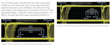

Moving from theory and datasheet to reality, I decided to actually look at the CAN bus in my plane. I have the typical 22 gauge Tefcel twisted shielded pair wiring, not the special CAN bus stuff, and darn close to the 66 foot limit. I hooked the scope up at the AHARS, which is somewhere in the middle of the bus. Here are some pictures of CAN HI, CAN Lo, and the difference in red. While there are some edge artifacts indicative of reflection components, they are minimal, and noise is really minor. Looks like rise times are in the 66 to 72 ish nS and fall times are 140 to 142 nS. Pulse times are 1 uS and Hi and Lo signals are 1V each. Looks easily clean enough to have no problems. Also measured the twisted pair and determined its impedance is about 67 ohms, and prop delay is 1.57nS/foot.
So, given these rise and fall times and the prop delay of this cable, you can see how Garmin says around 66 feet max, as with the worst case transmitter to receiver delay/distance, the the impedance mismatch reflections end up pretty much absorbed in the slow rise and fall times.
