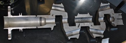

I’m working on converting my FP back to CS and while the crank plugs were out I figured I’d give this a try. I was able to see all 6 lobes. This is a narrow deck O360.
OK - excellent - now how did you do that? What kind of super-pretzel borescope are you using there?

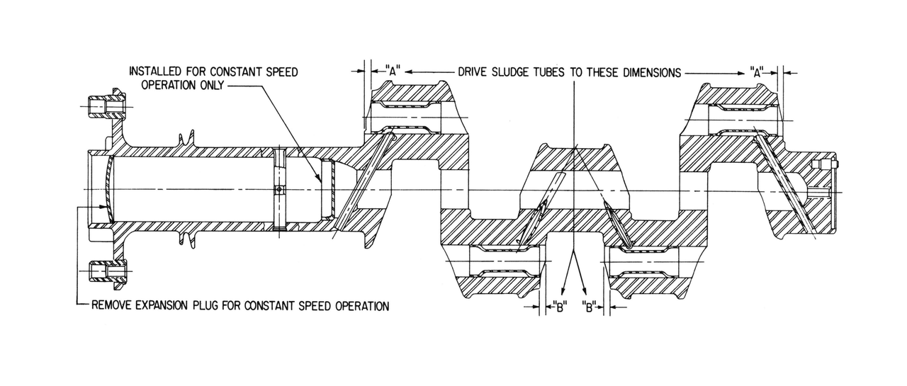

I am struggling to visualize how a scope gets from the forward hollow portion back into the core of the crankcase. It has been a while since I looked at a crankshaft and just cannot get my head around the path.

Here I am- I wish I took more photos and video during this but I was on a different path at the time...
On my hollow crank, the rear plug (about 8" back from the front) looks like a freeze plug. Some of these hollow cranks have a small pipe plug in this location, so I'm not sure if the borescope will go through that small opening. This "freeze plug" was not in place on my engine (set up originally for fixed pitch). So when I pulled the front plug and looked inside past where that rear plug would go, I saw connecting rods. I turned the crankshaft and the rods moved out of the way. That's when I got the borescope idea. The VA-400 borescope is about 20" long and has an articulating head. I inserted the scope and when I got to where the rods were, I articulated the camera head upwards and viola- there was the cam! I then straightened the camera and inserted farther in until the next opening and articulated up again for the next set of lobes. I then went farther back yet (the whole length of the borescope was inside, including the handle stuffed inside the snout of the crank) and was able to see the last set of lobes.

Here’s more pictures with and without the rear plug in place. Also the very last lobe. You can see the split of the two rear case halves.
This video has a good camera angle to visualize how the borescope was routed:

This cross section is good for the inspection understanding, but the mains have a drilled passage that feeds oil to the rods. This is typically fed with a center groove in the bearing. With lightening holes, the cross drilled passage can be at an angle to miss the lightening hole, but there in the center main bearing is a pesky hole into the lightening bore. What's that?? Some designs use a plug in there to allow oil distribution by sealing the bore, which is fine, but the design of it matters. It could be a dog-bone sleeve pressed in allowing the borescope to pass. Can anyone confirm that aspect of this design? Rocketbob?
Using this method one can't get a good look at tappet faces so its of very limited usefulness. Pulling the spinner and prop and plug, getting a new plug and installing it is more work than pulling a cylinder.
