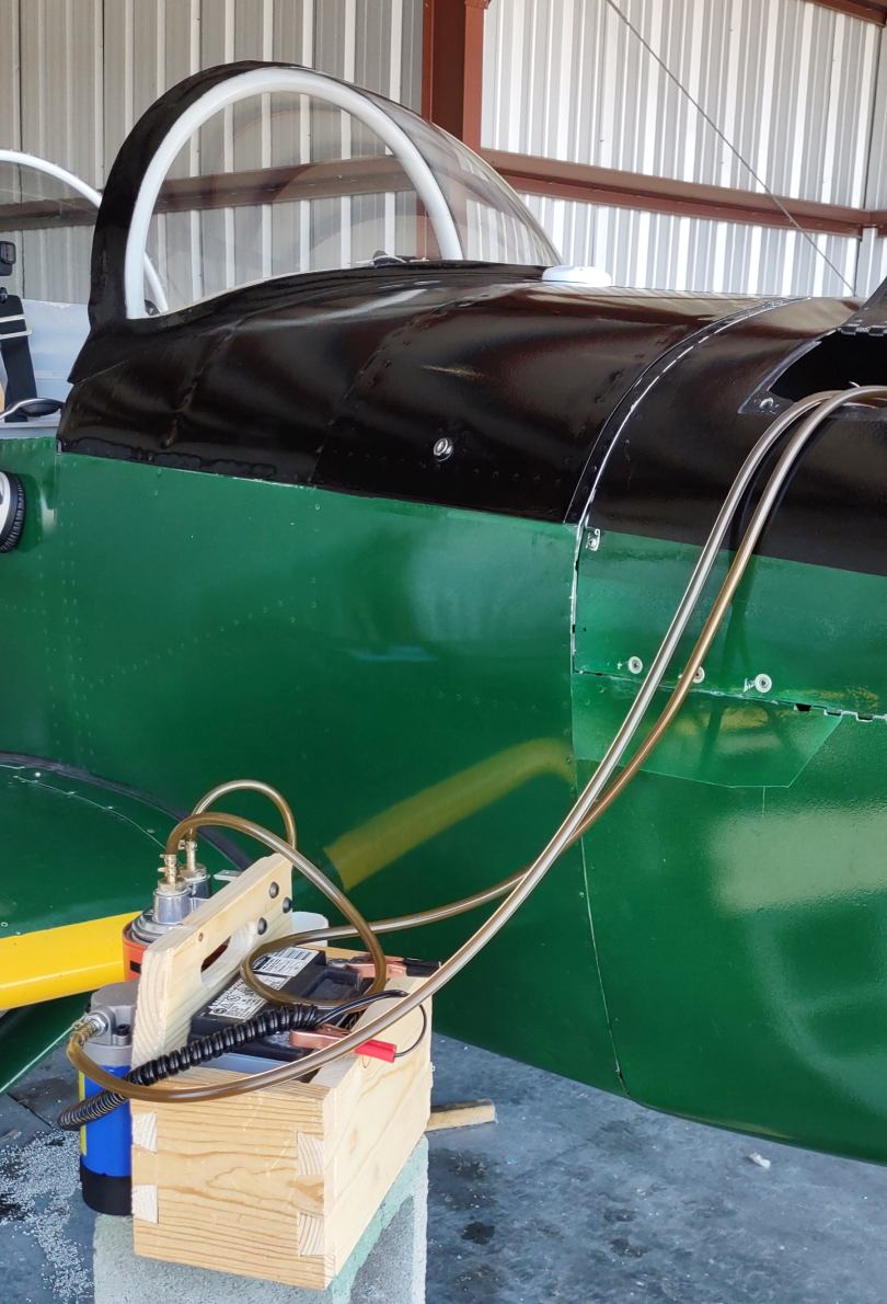

Was inspired by this thread to build the "clean cart". Used this pump and filter mount. The battery I replaced at annual and some tubing. Didn't get a picture of the end that goes into the fill spout, just two 1/4" tubes. 24" to reach to the bottom of the sump and 21" with the end squeezed shut and a hole drilled in the side, hoping for the exiting oil to shoot out the side and not just loop back to the input. Some scrap wood for a carry case.
Tried it out for the first time after my flight today:
Need to replace the tube on the suction side to something reinforced, it partially collapsed on the hot oil. Still pumped quite fast. Let it run while putting away my headset, parachute, etc. Maybe 10 minutes? Based on the 0.5 gal/minute spec (which I probably didn't get due to the collapsed hose) that would run all the oil thru at least twice.
Did end up having to add oil afterwards, around 1qt stayed in the hoses and filter.

Some of this will go away if we ever get a no lead aviation fuel. Of course that fuel will cost a few dollars more per gallon. What it will do is let the Lycoming's and Continental's use synthetic oil and increase change intervals to at least 100 hours or more. Rotax recommends 100Hour oil change intervals if the engine is run exclusively on unleaded fuel and the oil used is synthetic.
Interesting to me that the TBN values are much better with the bypass than without, but the oil is still "worn out" at 50 hours.
Considering this last load of oil was just about as ideal an operating condition as possible in a light aircraft (almost entirely long range, LOP cruise at stable temps and RPM), then I wonder what else I can do to get the recommended >2.0 value?
Send a brand new oil sample straight from the bottle, and see what was there to start with....
I was curioius what TBN meant. Internet says....
In short, a TBN (Total Base Number) measures how much base (as in base vs. acid) additive is in the oil to offset the effects of acids coming into the oil from combustion and other sources. Scientifically speaking, the TBN is one of two “neutralization number” tests run on oils.
