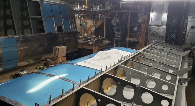

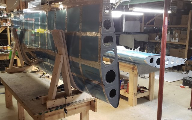

Using wing riveting as an example, the higher table is just the right height to rivet the ribs and the top skin. The top skin riveting is done with the wing vertical on the spar and secured to the table. Then the wing goes flat onto the top skin (use some carpet on top of the table) to attached the leading edge and gas tank.
For the harder bottom skins, two wing stands secured to the lower table provided the perfect height to do the “reach under the skin” rivet bucking process.
The lower table is also the right height for fuselage assembly.
Three RVs came off these tables.
Side note - an additional 4’x6’ table on wheels comes in handy for part prep and such.

Carl, I agree about the heights. Also, I love your wing cradles. I made a more "standard" wing rack out of a rack someone gave me, leftover from their RV-7 build. It has casters on it, so I can roll the wings in and out of the shop for storage or working. I widened the cuts in the rack end, and made slings out of carpeting similar to yours. I like the idea of having a sling rack that can sit on top of a table, too, like yours.
I also like a 37” high working height, and my latest work bench top is 78” X 30” with 3” overhangs for clamping made from 3/4” plywood for the top surface, with a 3/4” base surface underneath, inside the 3” overhang. It’s a very solid work bench and is mounted on full swivel, locking ball bearing wheels so I can move it around my workshop easily.
