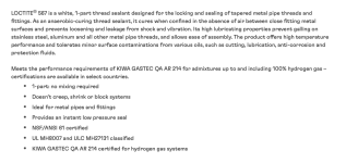

The Matco brake people recommend Loctite 567 for the NPT sealing. It has worked for me in similar fixes.
Well....replaced the shark bite fitting last night and used the recommended loctite and unfortunately the issue persists. My next course of action is going to be replacing the line. I suspect that maybe the one brake line is perhaps a touch too short and the bend required to get it into the fitting is creating too much pull. As a side note, it only leaks when actively braking. I clean up the fluid and there's no new leaks when returning to the plane even days later.
