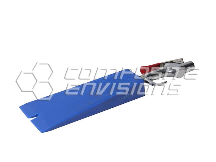

They make a gadget that helps with this if a layup is stuck. It's a thin wedge with an orifice that squirts shop air out the pointy end. You have to be able to get at least one section lifted enough to get the wedge inserted though.
I've laid up quite a bit of fiberglass and am happy to say that I've never needed to buy one...yet.
Damn, they have a tool for everything.
