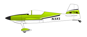

You can download 3-view CAD drawings from Van's. Then use AutoCAD or equivalent to draw your ideas. You can fill the shapes with "hatch" command in various colors. That's what I did 19 years ago.
Also, a tip for laying out the paint scheme on the fuselage and wings: use an LCD projector to project the drawing onto the airplane and then use narrow vinyl masking tape to follow the projected lines. That worked much better than trying to eyeball the curves based on a small paper drawing.
AutoCAD drawing:

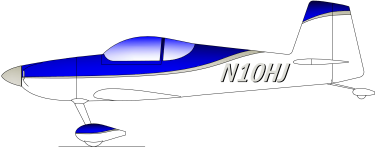

Just one step above that, I used Mayura Draw way back and someone was selling vector three-views of the RV models. I blundered around the program and eventually came up with three color variations on a theme; red, blue, yellow, printed them out and taped them to the wall by the door for a few months. My eyes always went to the red version, so that was the one!
