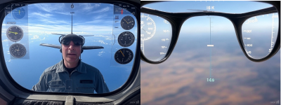

Practicing a little BFM with my HUD in DOGFIGHT Mode
My son and I have been adding some interesting functionality to our HUD project now with the addition of several DOGFIGHT BFM modes. I completed some testing this week with both Video Camera/DVR fixes and LCOS fixes. WE use ADSB between own ship and TGT to provide ranging and have a Gun Funnel mode for unranged practice BFM. LCOS graphic display is based off of some digital HUDs we are familiar with the range ring active inside of 9000 feet and closer. The ADSB function filters out all but the closest ADSB tgt and provides ranging to the HUD LCOS along with Tgt N-Number and other info for display on the HUD. Currently there are 4 Dogfight Modes in the software, 1 LCOS and 3 GUNFUNNEL (unranged tgt) modes selectable for wing spans of 25/30/&35 feet. HUD functions are controlled by a 10 Key pad just below the HUD with a number of functions changed through multikey presses on that function key. It's pretty clear over time I'll need to expand my HOTAS switch functions and not just use a keypad. The attached pictures are screen shots from my latest test flight Gun Camera Video. I'm using a micro video camera designed for the FPV Drone Racing world with a micro telephoto lens and the camera is mounted inside the HUD and Pilot FOV, the camera is connected to a 4 hour micro HDMI DVR that works great. Camera has a ND32 filter to help get rid of the Prop Blur. Still lots of little software issues and calibration test flights ahead but I wanted to share the progress with those that may still be interested in a HUD for their RV. You will notice that this awesome little HUD is still clearly visible on this bright sunny day even when flying directly info the sun as is shown in the Grayish Video shot (heading 113degs). You will notice some blurring in the video's caused by camera vibration, not a HUD issue, just the camera, a significant improvement to what it was at first but still annoying (prop has been balanced). I'll be giving a Forum at Oshkosh on our DIY HUD project progress and will include some of my HUD gun camera video. Anyone wanting to get involved, install a HUD in their aircraft, or help out in the project is welcome to contact me.
