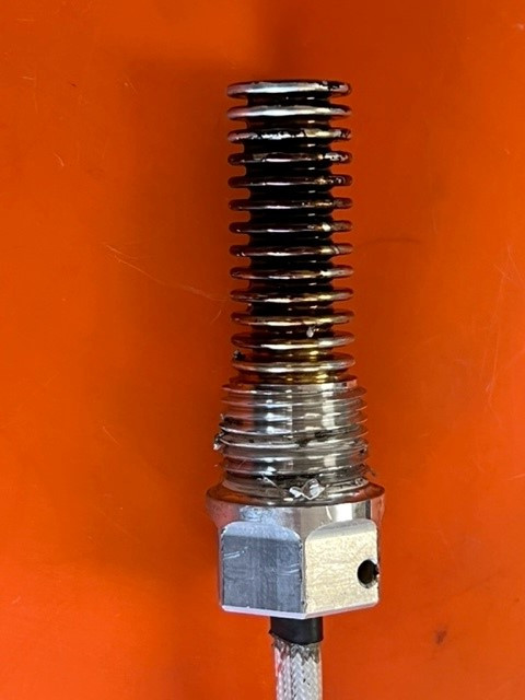

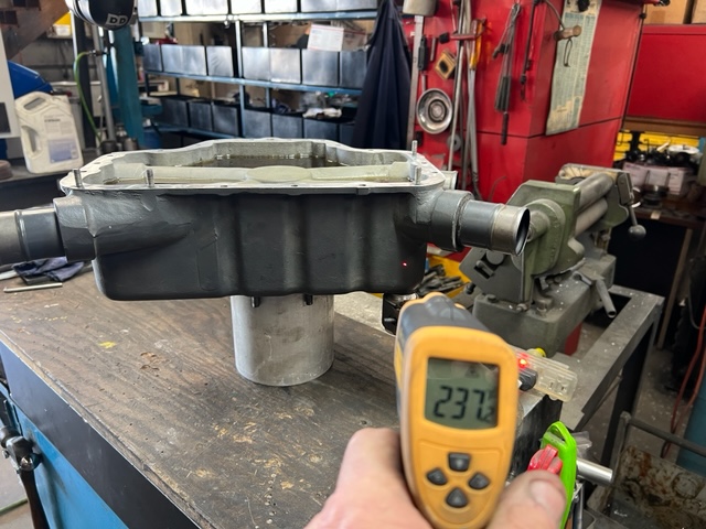

...The oil sump sitting in my shop with seven qts. of oil has been plugged in for
over six months with zero coking and all is perfect. Oil looks as new, heater is fine,
but you need to be very careful if you have any pet bugs! If they land in it,
they won't fair well. Does that require labeling? This is California!-:confused:-:rolleyes:
----Photo of this unit as removed from sump after six plus months of continues use.
In the higher ambient temperature environment of my shop, with no coking. I think this
would appear even more pristine were it in a aircraft being airborne on occasion
with the detergent action Etc. We will have these back in stock soon! Thanks, Allan-:D
