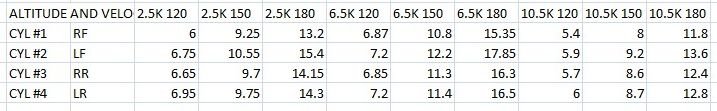

As far as heat is concerned. Contrary to what many believe, the front cylinders are often the worst cooled cylinders. Airflow coming from the front of the cowl ski jumps over the the front cylinder and ends up cooling the back ones better because it hits the baffling and is forced down through the back fins. Think of the direction the air is flowing into the cowl, it's not straight in. It's at an upwards angle, aimed at the top of the cowling because of the aircraft's AOA. It's also interesting to note that some airframes specifically have higher sticking occurrences than others; which would indicate that it is not an inherent engine design issue and more of a installation/cooling issue. The #2 cylinder has the exhaust side facing back, so if air is skipping over the top that cylinder, that side of the head will be hottest. That's why you likely see it on the #2 and not #1. Lycoming tried to help with this by giving that side of the head significantly more fin area; look down at the head from the top of the engine, the fins are way bigger on the exhaust side. But if air isn't going over that side of the head, it won't matter.
