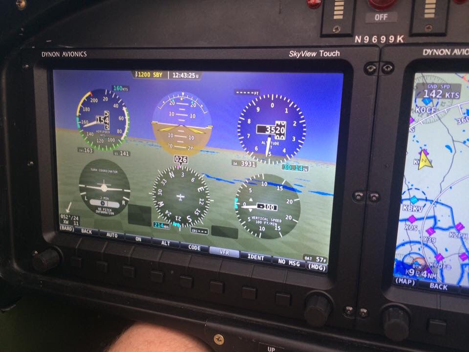

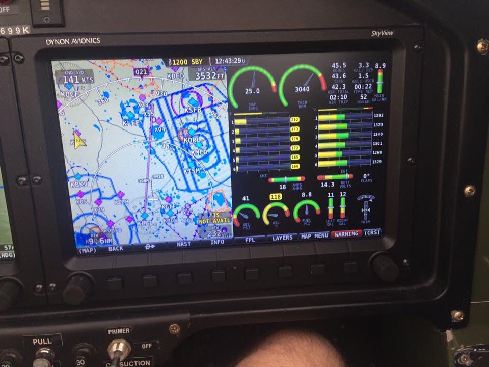

Into the blue
Big BIG news today!!!
First flight was accomplished today. I’m pleased and exhilarated to report that she tracked straight down the runway for takeoff with just a little right rudder, climbed out straight and true, flew around the patch for a little while just as steady as a rock with the ball centered hands free no heavy wing issue ( really relieved about this considering the troubles others have reported) . Did some slow flight and then couple of non-event stalls , breaks were preceded by a slight but quite attention getting buffet and a straight forward nose drop without any wing dropping , lightly relaxing the back pressure and she was right back to flying, adding little bit of power right back to straight and level . Coming in to land pulled power little too much and that big 84” prop was like a “drag chute” putting the breaks on had to put a good bit of the power back in to arrest the surprising distant rate:eek: after this dose of self inflicted excessive excitement, she rolled right on the grass with just a little bounce and only one, rolled out nice and straight to a no breaks needed stop in about 450-500’
