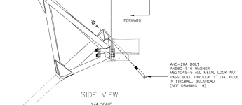

I highly doubt that misalignment is from the bolt. The gear leg slides into a 6" long socket and that holds it together. The bolt just keeps the gear from falling out of the socket. It could be a bend in the leg up near the socket, as it appears straight in the pic. However, the leg tapers and becomes thicker near the top, so bends should occur lower on the leg. Most likely the socket was not positioned properly in the jig when your engine mount was welded. Would only need to be a degree or two off to create this minor misalignment.
With the RV-A legacy nose gear legs, they are actually the same diameter util going into the socket and then get larger as seen in the photo below. However, the main gear legs taper all the way up and into the socket.

...And the attach bolt isn't a "Shoulder Screw" -- It's an AN5-20A -- see attached:
That picture is very explanatory, thank you. My investigation thus far is preliminary to the extent that I haven't even de-cowled my airplane yet, nor have I reviewed my plans. I've only looked at the Van's thumb drive but that only shows the "new" suspension version nose gear.
