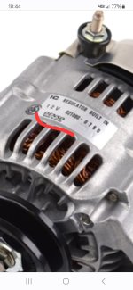

How do you know if the alternator is an actual Denso and not a high priced clone posing as an actual Denso alternator? Will an actual Denso have on the IR Denso written on the IR?
says Denso on the tag, the wires coming out of the back get jumped together as they exit the alternator, and ran out to the toggle switch to toggle battery power on, thats your field. I always srart with battery and field off and toggle both on after engine start, doing it that way for 9 years and the Denso still going strong.
see second pic, the top wire is jumped to the bottom wire and the bottom wire runs out to your toggle.

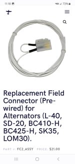

you can buy the prewired field connector jumped together from BandC for $21. its the L40 alternator harness https://bandc.com/product/replaceme...-alternators-l-40-bc410-h-bc425-h-sk35-lom30/
L40 alternator https://bandc.com/product/alternator-40-amps-homebuilt-2/#bracket-configuration
I just used the L40 harness on the Denso alternator, this is the same alternator as the L40 but only $139. https://www.ase-supply.com/product_p/nd-021080-0760.htm
