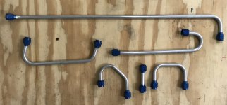

What rigid tubes are you having issues with, or wanting to change? These?
Understand that -6 teflon hose doesnt like to bend as tight as a tube, although tighter than you think. And, due tothe configurations of some of these tubes, doing them in hose would be 'challenging' to say it nicely.
Rigid tubes per the plans can be done. Take your time, lot of practice even for a builder thats well versed in bending and flaring.

Even if you did use Flightline Specialty’s fuel lines, it doesn’t include the looooong F-12127D line, which is the most complex to fabricate. So, you’d still need to sharpen your bending and flaring skills.
That's an optional one. It's in the popup.

I truly think the Flightline Specialty’s fuel lines are probably better than ones an ameture can make. However, I DID contact Van's... here is that exchange:
SENT: "Aircraft Specialities (Flightline) offers prefabricated rigid fuel line kits for the RV-12iS.* Would using these void my ability to register my plane as ELSA because I did not purchase them from Van's?* If so, would Van’s authorize using this product?"
RECEIVED: "I am afraid this is something that a DAR might disqualify you for ELSA if found. Having never used these in our design or having tested them we would not be able to offer you any authorization to do so."
Additionally, Van's uses 3003 tubing for fuel lines and Flightline uses 5052 (used in certified aircraft I believe). So, they do not use the same material as others have stated.
I am hoping a DAR will chime in on this topic!
TRUE---we use 5052O tubing versus 3003O that is Vans supplied. BUT, the assemblies are made to fit the locations. NO, they are not builder made so that is a gray area. BUT---if they are installed on the bulkhead for inspection, I'll bet the DAR might not even give them a second glance---or even know they are 5052O.
Yes----the intent of the regulation is that all the parts be supplied by Vans and assemblied to their plans. In that respect, we 'could' make them for clients from 3003O and meet the intent of the regulation.
