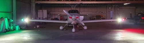

I’m going with ‘the works’ package from flyleds for my 10, Pauls service in his quick replies to any question sent has been incredible
I've been seriously considering the FlyLEDs works kit. If you were to do it again, what would you choose? I don't know if I want to do the leading edge light or not.
I would absolutely do it again. I really love the FlyLEDS kit. It does exactly what I want. I would probably add a light in the lower cowl versus putting it in the leading edge. Aero sport has a kit for the cowl landing light.
What I love about the FlyLEDS kit is that I have the landing w/ wig wag, nav, strobe AND taxi light all in one. The taxi lights work really well - and like I said, the landing lights work really well too - super bright. But the way those tips are, there is a shadow.
That said, I don’t fly a ton at night, so for me, its sufficient. There is enough spillover into the middle of the runway, that I can still see.

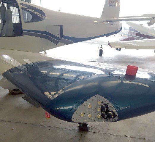

FlyLEDs recommendation?
So to light up an entire RV10 all around, what FlyLeds packages are recommended (including any tail/beacon, landing/taxi, nav/strobe). Is it the works plus the seven stars, plus a sigle light for the tail?
Hi Jacob
The RV7/8 wingtips have a very large light bay so the Works kit works very well with these, however with the RV10 you may end up with a shadow cast directly in front of the nose as mentioned above.
For a plane as capable as the RV10 we recommend installing leading edge light bays from Duckworks or with RV14 parts, which then enables you install either our Combo or Seven Stars landing lights. Lots more light, and it gets to spread more evenly in front of the plane with these as well.
A complete lighting package would consist of:
1: The Original Flyleds kit for the wingtips,
2: the $99 standard tail light. That covers off your position and strobe light requirements. No beacon required.
3: We then recommend installing light bays in your leading edges, as this is the best location to put landing lights.
You then have room for our Quad Spots for "Excellent" lights, or for the best of the best, our Seven Stars lights, which tend more towards "Outrageous!".
For those who can't bear the though of cutting into the leading edges, The Works kit plus a tail light offers you a complete lighting package (1, 2 and 3 above) without the mental challenge.

This plane has two Seven Stars lights, along with The Original Flyleds kit in the wingtips.
From a slightly different camera angle:

Hi Stephanie
Post 27 in this thread gives you the options we have.
While our The Works kit in the wingtips has proven to be very popular, the light bay on the RV-10/14 wingtip is quite small, which leads you to having lots of light from the Flyleds kit but you will have a shadow or dark patch in front of the nose.
We highly recommend putting landing lights in the leading edges. This allows room for bigger lights such as our Combo or Quad Spots, or for the best of the best, our Seven Stars. Lights placed here gives you a much better beam spread in front of the plane.
The RV-10 doesn't come with leading edge light bays by default but the RV-14 does. -10 owners can order the parts to make the bays from Van's.

I suppose I could have adjusted the focus more toward the center but the taxi problem would still exist as the lights are very, very bright. Definitely not very nice to other aircraft in the area…
Thanks for clarifying. In the photo, it looked like your lights were installed in the wingtips.
I'm surprised you experienced a dark area directly ahead of the aircraft with the lighting in the leading edges. I thought that problem was typically the result of lights mounted in the wing tips.
I have Baja in my -7 tips and don't notice any dark areas, but . . . I used lenses (purchased separately) with 50% diffusers. One horizontal and one vertical. This seems to work but is not a (typical me) scientific report. Maybe it is just dark where I can not see anyway being 18 deg pitch angle on the ground. The lights are outstanding, JMO.
