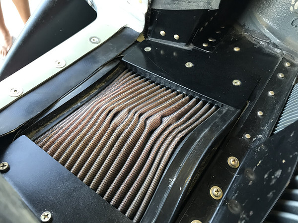

Well, this was unexpected. I came home from a short (1.2hr) test flight, and lo and behold during my post-flight walk-around I saw this inside my air inlet:

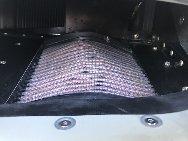

Here's another view with the cowl off:
IO-360-M1B, horizontal (snorkel) induction.
It looks like something caused the air filter to buckle and bend up out of the snorkel. Obviously it needs to be secured better, but what are the physics that would cause this to happen in the first place? I thought that the engine is always "sucking" air down through the filter element, and you're not going to see any back pressure from the snorkel.
No indication of trouble in-flight. My CHTs and oil temperature were a little high, but I've been struggling with CHT temps all through phase 1 so it was not unusual.
Looks like I'm on the hook for at least a trip to the Aviation aisle in Autozone for a new filter. I know the filter can probably be bent back into shape but they're not expensive. I'll need to build a better "top" to secure the filter body. I have some ideas--maybe something braced diagonally across the top to hold down the whole thing. Anyone have any good designs?
I don't think you need to modify the filter hold down at all, just find out what caused the deformation.
Just for a data point, before first flight, I had a back fire and the filter never moved and its held down just like yours.
No huge backfiring observed. I get the usual little baby "pop pop pops" when I reduce power to descend, but nothing monumental that I recall. Maybe I missed it. Sounds like the consensus here is backfire.
Looks like it was compressed from the sides like you see cards bend when shuffling. Was the fit super tight and it was wedged in place causing it to finally bend and pop out?
Looks to me like the sides of the filter got squeezed inward, causing the filter deformation. If it were me, I would get the cowl off and closely examine the snorkel and the baffle ramp assembly. You are looking for what will hit what when engine moves 1" in any direction. Guessing the snorkel assy is hitting something during the more extreme vibrations seen at startup.

I can predictably trash a filter like this with one false start backfire. Most always I can tell it happened, but it does happen on start, usually when everything is cold.
Just like the previous post said, over rich on start and the flow reverses thru the intake, deforming the filter upward. Mine is a little more secured than yours (mine is not exactly per plans, added some retention not called for), but the shape of the filter folds are almost the same.
My new technique (you learn faster after $45 penalties) is to prime less and feed the mixture in during the start. Not 100% but it's working pretty well to avoid this issue.
BTW The filter will hang in there and do the job for a long time after this happens, but seeing a waffled filter in my intake path gives me the heebies thinking about where the trash might end up if it comes apart ...

Pretty sure its not a backfire
No way this is a backfire. During my phase I on an RV-14A, I had something similar....not exact but similar. I had squeezing that deformed the air filter bracket hold down. The problem was with the RV-14, you build up the cowl to add a rubber flange to seal off the air box. My build up was a little excessive and it created a squeezing effect on the air box. I inspected everything carefully and removed some of the flox build up and re-positioned the rubber flange and it relieved the "squeeze" and I've had another 50 hours on the airframe without any more squeezing. I am confident that you will find this has nothing to do with a backfire and everything to do with cowl fitting and such. good luck

Backfire on start up. Caused by a lean start. Prime for 1-2 more seconds. I've replaced dozens of these on customers RV's in 28 years. P/N 33-2060

That's from a backfire. Ive replaced a few that looked identical to that. I now no longer hot start with the throttle open more than a half inch. The butterfly in the fuel servo will prevent the backfire that blows out or deforms the filter. Have not had one since and that was years ago.

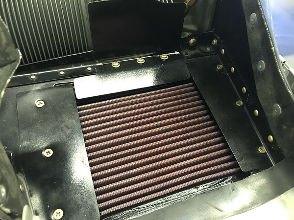

You guys are great. I think we're ready for some corrective action, here.
1. No more experimenting with hot start technique. I'm going to switch back to what I know works.
2. Filter security. I deviated from Van's plan a bit on the airbox, so it's up to me to better secure the filter. I re-did the left side "air dam" in front of the #2 cylinder to include a hold-down tab for the air filter. This should help keep the thing in place should I ever backfire like this again:

First post to this forum, we have an RV7A freshly out of its 40 hour fly off that experienced this same problem in the HOT weather in Texas. After refueling and restarting, we experienced a backfire during our hot start up. When we applied power on the takeoff roll after a normal runup, the engine did not develop appropriate power and we aborted the take off. Upon inspection, our airfilter - attached in a very similar way to those shown here - was actually displaced.
Again about 10 hours later (also in very hot weather), we experienced a small backfire after a hot start. So we shut down and inspected; the filter was deformed as in Draker's post.
Now chasing the cause of these backfires (haven't experienced them in the cooler weather as we flew to Oshkosh from California) but know that any backfire with this horizontal induction filter will signal shutdown and inspection of the filter. One is on order to replace the current part - and they are not cheap!!! Going to try that hot start with Throttle only open half like wnplt and see if that helps!

I also had this thru the intake snorkel backfire.. After talking to Air Power on my IO3601m, I was told the idle mixture was set to lean. Adjust the idle wheel to make the mixture richer during starts... No more backfires.
You may need to adjust the Idle RPM after making mixture richer.
