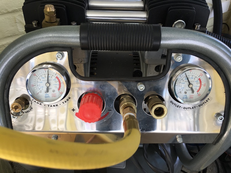

I don't understand my air compressor's regulator ? When I set the output pressure to something lower, like 40, it will initially shoot out at 40, but within seconds the output pressure will fall to close to zero. If I modify the output pressure while continuously using it then when I stop using the air it will creep up to something like 100. Then when I use it again it will initially start out at 100 and then quickly drop down to the 40 which I initially wanted.
What's going on here? Is this how it's supposed to work?
I can make it work with my rivet gun if I'm careful, but it's certainly not ideal. Are there ways around this? I also have a brass inline regulator on my rivet gun but I don't understand it yet. Too many variables. Ugh.

When I get to the shop today, I will take a photo and post it...(or try to)
This is what I have
Here's a video of what it is doing with an air blower: https://youtu.be/IyVJu_UIbKk
and this is what it looks like:
Looks normal to me. That is what they do. As previous person mentioned, you set the pressure with the tool running/flowing and ignore the pressure shown when the tool is not running. The delta will be different for each tool, based upon it's flow rate.

I just went and set mine to 60 psi and with an air blower it dropped way down to 55 psi. Tank size, compressor rated SCFM, has nothing to do with this regulator. I simply does not function properly 30psi drop is too much. It may be design, maybe an internal failure, but it is NOT NORMAL for a proper regulator. Back to Mike's first comment, it could be some internal restriction of the manifold.
More than 10psi drop is an issue for any regulator, they don't have to be expensive. If you have a hose connection to full tank pressure, put a regulator on a quick coupler at the end of your hose and try that. If it does not work properly then there is an internal restriction.

Found the problem
To those who said it was the regulator: You were correct.
I bought a new hose and new regulator today at Harbor Freight. Swapping out just the hose didn't help. They were both 25' long, so length clearly shouldn't have been a problem. Next I added the regulator. Yup, that was it. With the new regulator I only got a 5 psi drop while using my tools. And my rivet gun doesn't smash through rivets anymore.
