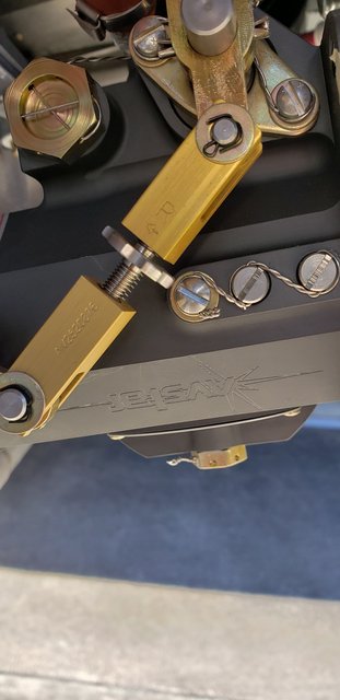

The one last thing blocking my (IO-360-M1B) first flight test is an incorrectly set idle mixture. I'm still seeing no RPM rise when pulling out the mixture, which indicates an overly lean idle mixture. Tried rotating the idle mixture adjustment wheel on the servo in the "enrich" direction. The only effect it had was to reduce my idle RPM to the point where it wouldn't even idle--obviously there is interplay between idle speed and idle mixture so you need to get them both right. I don't have a good intuitive feel for how much I need to rotate the wheel. 1/4 turn to enrich it properly? 1/2 turn? 3 turns? 10 turns? Who knows? I'm kind of fumbling around in the dark. Then, once I get it right, my idle speed will be off, so I'll need to re-adjust the screw again, which will throw off the idle mixture maybe? Good grief!
I fear that doing this by trial and error is going to cause me to start and stop the engine 100 times before first flight. That doesn't sound nice for a brand new build. Should I be worried about limiting the number of start cycles before I get off the ground?
Also, yes, I know you can do adjustments on a running engine, and no, I won't be doing that.

Note - the stock AVSTAR fuel manager was recently replaced with the very nice AirFlow Performance FM-150C. This new version from AFP is designed for the Lycoming forward facing sump. The install kit from AFP is bolt on, no changes to throttle or mixture cable brackets and no change to the snorkel. I suggest those still waiting on their IO-360-M1B ask for the AFP system.

Note that the upper lever is not indexed to the shaft. That means that most of the units will have a slightly different spacing on the turnbuckle. So the OP cant realistically set it based upon your picture.

Because you went past it while twisting the red knob. It is easy to do, as it is a very fine resolution, which is why I recommend a different method. If you kept richening it to the point that it ran really rough it seems pretty un-imaginable that you are too lean. You can go a long way on the rich side before it runs really rough. Can't do that on the lean side; A few small adjustments and it just dies.

This'll work, but you're almost out of threads on the upper end. If'n it were me, I'd remove the linkage, measure, and then adjust the knob to re-center it in the gap and keep the same dimension.
As it is, it violates my sense of symmetry and order in the universe :).

Draker, I found this manual online..on Step 5, they have you move your mixture control really slow to note the RPM rise, then before the engine quits, you can go back to rich and keep it running. I know you don’t seem excited about making changes to a running engine, (and I don’t blame you!) but there are mechanics that do this every day and perhaps one of them can help you get it set very quickly.
https://precisionairmotive.com/wp-content/uploads/2019/06/SIL-RS-67.pdf
Success
Had a day to tinker some more and met with success! Before I reveal the verdict, I want to give a big thank-you to everyone who chimed in to help. This has been a really informative thread and I feel I learned a lot here.
Verdict: So, even after my earlier attempts to enrich the mixture, the mixture was still too lean. When I initially adjusted it, I was afraid I was enriching it too much without results so I stopped and posted to VAF. But it turns out I should have just continued because I only needed about 1/8 of a turn more to get it right. As for why the engine had trouble after enriching last time, that remains a mystery—it was fine the whole time today.
As for detecting the RPM rise, what ended up working for me was very slowly reducing the mixture (twisting the vernier knob in the lean direction until I could see the rise on the glass display). Doing it this way it was very clear and easy to measure the RPM rise.
Started at zero RPM rise, gave it 1/8 of a turn and observed about 50-60 RPM rise on lean-out. Gave it another 1/8 of a turn and observed 100 RPM rise (too rich). So backed off 1/8 a turn, saw 50 RPM rise, and I think I'm done. After all this I had to re-set the idle speed. I could get it to idle smoothly at 700 RPM, pretty rough at 650 RPM, and 600 RPM was so rough it stumbled and would quit. So I'm going to keep it at 700 RPM at least for Phase 1.
Big thanks again, everyone. This is truly the plane that VAF built!
