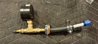

I just finished rudder pedals at weekend. Before I fit them, I'd like to do the fuel line testing like you guys. I don't have the fuel pumps + filters yet but it's those connections inside the fuse I'd like to know are okay before moving on. I'm not sure how to do that, could you please share a little of what you did? How do you cap off ends etc would be really appreciated. Thanks :)

I started with the hose and fittings that come with the fuel tank testing kits. I put the cap on the return fitting in the firewall, and the hose on the supply fitting. I purchased some additional AN fittings (AN926-6 caps and AN806-6D plugs) to cap the fuel tank end of the return line and the fuel pump end of the supply line. I picked up an inexpensive pressure gauge and some miscellaneous parts from the local hardware store to attach between the hose and the valve that came with testing kit, then pressurized the whole thing to 60 psi and left it over night. Initially I had some leaks which I tracked back to the hose clamps clamping the fittings into the hose. They had to be much tighter than when testing the fuel tank. Once those were tweaked, the pressure held at 60 psi for over a week, changing only with the temperature.
My testing setup may have been overkill, but it was worth a few dollars to be certain I wouldn't have to get at those firewall fittings again.

Perfect, thank you :)

I did essentially the same, using AN caps I got from ACS.
