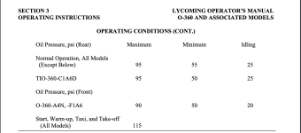

But -- with the caveat that a too low Oil Temperature *will* cause a too high Oil Pressure when you get the RPM up to take off speed.
Again, referencing the IO-360 Operating Handbook (link https://www.lycoming.com/sites/defa...0%26%20TIO-360%20Oper%20Manual%2060297-12.pdf) page 3-12. Maximum Oil Pressure 115 PSI. (screen grab attached)
FWIW
