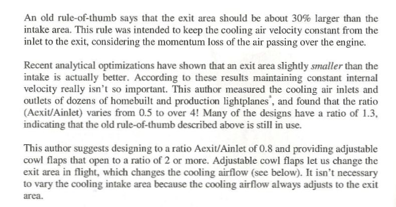

Some of you may be familiar with Dan Raymer's "Aircraft Design; A Conceptual Approach"
https://www.amazon.com/Aircraft-Des...preST=_SY291_BO1,204,203,200_QL40_&dpSrc=srch
More recently, Raymer released "Simplified Aircraft Design for Homebuilders", which is well worth a few bucks:
https://www.amazon.com/Simplified-A...preST=_SY291_BO1,204,203,200_QL40_&dpSrc=srch
Anyway, I was amused to find this passage in Simplified Design:
Like all rules of thumb, reality depends on details, so don't get too locked on the given ratios. Given a variable exit, a wider ratio range just means a wider range of available mass flows for cooling, from a little to a lot. As noted in the last sentence, the exit is the throttle.

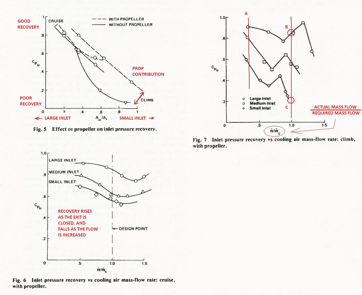

Returning to the propeller's contribution to climb cooling, here's a paper some readers will find interesting:
https://ntrs.nasa.gov/archive/nasa/casi.ntrs.nasa.gov/19980214913.pdf
In the past I've soapboxed a bit about low velocity ratio inlets. The ever-popular NASA CR-3405 illustrates better pressure recovery given low Vi/Vo, "Vi" being velocity through the inlet opening and "Vo" being freestream velocity.
AIAA 80-1872R expresses essentially the same thing as a ratio of stream tube area to inlet area. The stream tube area is the cross section of an imaginary tube of air (viewed at a point well out in front of the cowl) whose mass is equal to that which will actually flow through the cooling system. Flow restriction determines the cross section area of the stream tube; usually the cowl exit is the throttle. I say usually only because it is possible to build cylinder baffles so tight that they set the flow rather than the cowl exit (hello Bill), and in fact the researchers here used a variable orifice plate to simulate baffle restriction and vary total mass flow for their measurements. The stream tube expands as the air slows immediately in front of the large inlet, and as it slows, the static pressure rises. All other air in front of the cowl flows outboard and around the cowl.
Regular readers know I operate without any practical climb CHT restriction, and do so with less exit area than the stock RV-8 cowl. One key factor is good pressure recovery, and 80-1872R shows why.
Fig 5 plots considerable propeller contribution to upper cowl pressure in climb, as compared to cruise, just like the mirthful measurements in post 198. At the same time, note the difference is pressure recovery as the ratio of stream tube area to inlet area gets larger. Low ratio inlets (expressed in area or velocity) recovery a little more dynamic pressure in cruise, and a lot more in climb.
Fig 6 illustrates an important detail; varying the mass flow varies the pressure recovery. Increasing the exit area makes the stream tube larger. Mass flow rises, but pressure recovery falls. However, it falls less for the large inlet. What it means is opening a variable exit (a cowl flap, if you insist) in cruise results in a little less drag penalty when the system has a large inlet, because overall system pressure remains higher, thus exit velocity remains higher.
Fig 6 is for the cruise condition. Now look at the climb condition in Fig 7. All the inlets perform better when flow is throttled (A), but open the throttle so mass flow is equal to cooling demand (1.0 W/Wc), and the small inlet falls on its face (C). Meanwhile, the low area ratio (i.e. low Vi/Vo) inlet hangs in there at 0.8 Cp or better (B).

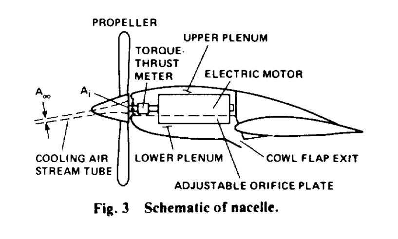

Ross, I installed piccolo tubes above and below the engine barrels/heads according to DanH drawings. Parallel to the base of the head and 1" above the fins. I used the same electronic manometer (Dan recommended) and flew triangles to correct the airspeeds. The static side was tied into the aircraft static system. Actual TAS was 2kts +.3 lower than the GPS speed.
If the recovery is 90% I assume the velocity is very slow, as is the mass flow. Cooling is good. Remember Allan Judy's RV6? He had an angle valve and a separate cooling duct for his (large) oil cooler, but the inlets were quite small. Maybe ~2" in dia with well rounded edges.
My challenge now, is what to do with the cowl exit. Near zero lower cowl pressure acting like an air dam. Either add an after body or sleekly reduce the exit area w/o increasing the pressure too much and reducing cooling. Unlike DanH, I do not have unlimited range of cooling. Maybe if we use the 435F and 500F limit, but not if desiring to stay below 400F on a hot day climb. Bragging about speed might be nice, but many faster birds out there already, it's really about the poor aerodynamic efficiency that bugs me. BTW - the aft lower cowl already extends over an inch behind the FW.

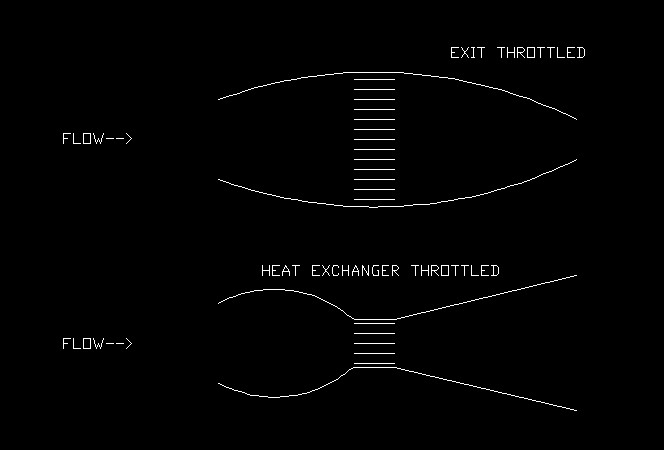

There are only two ways to carry away more heat. You must flow more mass or transfer more heat to the mass you have. Recall I asked about exit temperature? Yours is not very high, so if cooling is good, you must be doing it with mass flow. Think about it; you have a lot of deltaP.
High deltaP across the engine baffles also says flow through the fin passages is at high velocity, at least at some points.
I really want to see a data set before drawing a firm conclusion, but I'm beginning to think your extensive wrapping is too restrictive. We don't want the system restriction to be the engine baffles. We want it at the cowl exit.

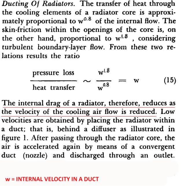

Consider this tidbit from Hoerner's Fluid-Dynamic Drag. The given values are for radiators, but something similar would be true for engine fin passages. I think the good doctor is saying that if velocity within the cooling passages is reduced, heat transfer won't fall near as much as drag, i.e. energy loss across the engine baffle. So, open the baffling a little, and clamp down on the exit; slow flow in the fins, maintain higher lower cowl pressure, and generate faster flow through the exit.
Dan is exactly right on the mark here. Especially this statement:
"I really want to see a data set before drawing a firm conclusion, but I'm beginning to think your extensive wrapping is too restrictive. We don't want the system restriction to be the engine baffles. We want it at the cowl exit."
I agree with Dan and Steve. With 90% pressure recovery, you've nearly stopped the air and with no variable geometry exit door you must have lost most of the cooling air momentum.

What we're proposing is moving your flow restriction from the heat exchanger to the system exit. Conceptual sketch:

Dan asked: "Can you tell us how the proposed test might be conducted, why, and what might be determined?"
Don, I apologize for not responding directly to this earlier.
John Thorp and I also discussed the "zero thrust" accessory developed by the CAFE Foundation. I recall John as being almost stunned by the intellect exemplified by this idea. I believe he wished he had thought of it much earlier. He approached the problem in the Navion by fitting a full-feathering propeller, but the CAFE approach was better to the point of being "elegant" (or something similar).
The test approach would mimic the Navion cooling drag tests by investigating different configurations by recording descent rates during glide tests under "zero" thrust. Tufting the cowl inlet and exits could provide insight into developing the next "configuration."
