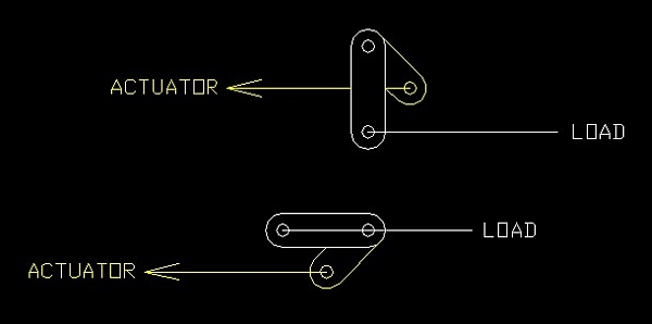

... if it's truly over center, that means it would be jammed, right? I'm confused on why you describe it this way.
Perhaps a poor choice of words. Let's try a picture.
The highest load on the door linkage would be when the door is closed, because that's when internal cowl pressure is the highest.
If we arrange things so that the arm linked to the door becomes parallel to the link as the door reaches the closed position, there is no resting load on the actuator. That's good for the plastic gears, which are subject to a bit more heat than the designer intended. Even better, as the door nears closure and resistance rises, this sort of arrangement provides a progressive increase in linkage ratio. Thus a little bitty actuator can pull the door shut without strain.
Top is door open, bottom is door closed.
Aha! Had to go back to your original photos and blow them up and compare with your diagrams, bit I get it now and also see how the over center arrangement with the door closed relieves stress on the actuator.

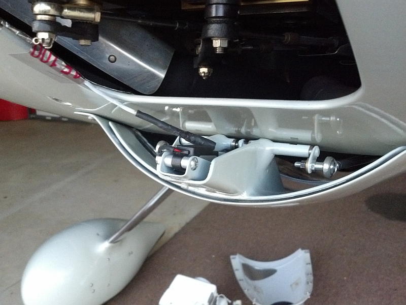

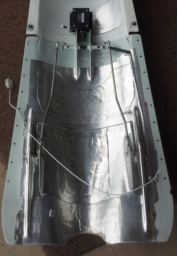

Here's one with the door more than half open. As the actuator pulls on its center arm to close, the arms on the ends will eventually parallel the linkage rods. Linkage ratio goes to infinity.
The black heat shrink thing on a wire is a temperature probe. The actuator was subject to about 160F in this location. As you can see the location shields it from radiant heating.

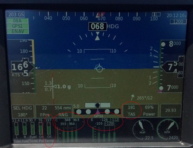

Pushed over and established the usual settings for fast cruise, WOT, set RPM, lean to 100-125 ROP for power, trim, altitude hold on. Indicated TAS settled in at the usual 181 knots, which is what I had with the previous exit.
Now the good part.....thumbed the switch to close the door, and picked up four knots....

Steve, I doubt a single pushrod would work for long, at least not in this general configuration. I'd expect the hot fiberglass door to warp torsionally.

Force On Door
could you get by with only one actuator arm... like a butterfly valve?
My max measured lower cowl pressure was 6.75 " H20 (relative to ambient static at altitude) = .24 PSI at Vmax. My door is 6" x 4" = 24 sq in. Force on the door at Vmax is about 5.76 lbs. Mine is hinged at the forward edge so the hinge and door feel the full load . Because Dan's is hinged and actuated at the center, when the door is closed, neglecting the slight pressure gradient across the span of the door, the force on his forward half should nearly oppose the force on the aft half resulting in nearly zero moment about his neutrally located hinge line - elegant design for sure! (the exit area begins to accelerate as it moves closer to the exit so static pressure in the cowl is not going to be uniform but for purpose of illustration and in consideration of the short span of the door I'll call it uniform...I know, I know)
Dan, your door may actually stay mostly closed without actuators since as the the door begins to open the dynamic pressure of free stream will act mostly upon the aft portion of the door creating a closing moment. I cannot tell from photos if the fwd and aft portion of the door are of equal area?
As Dan pointed out the heat on the glass plus the load will allow the door to warp. I saw this on the first iteration of my setup when I only had one actuator. After a flight with the door fully closed on shutdown the side without the actuator was still open about 1/2" my actuator arms are located near the aft edge of the door not at the hinge line. My first actuator was simply a push-pull cable (standard Van's carb heat type). After a Vmax run with the door fully open I returned to find the cable bent from dynamic pressure loads on the door when fully open.

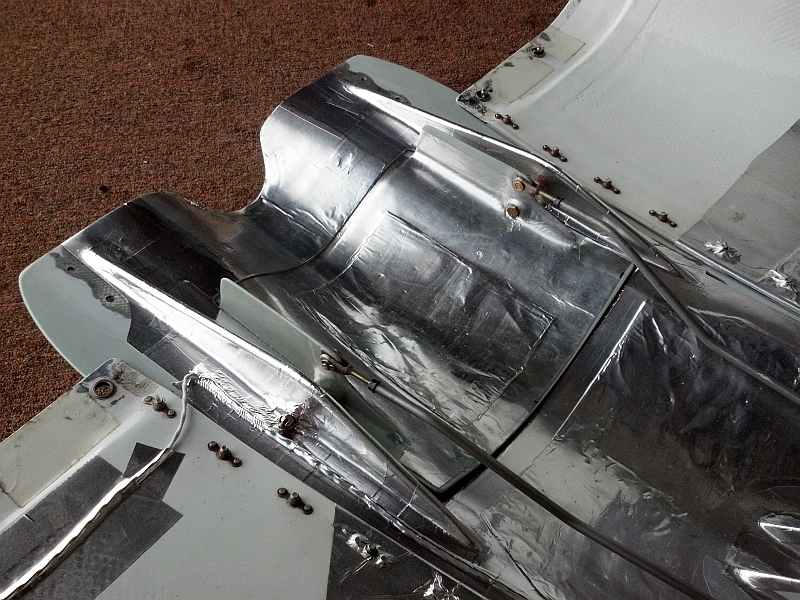

Rigged my old lipstick camera on a pedestal mount under the belly and taped yarn everywhere.
Good news and bad news.
Bad: At this time the door does not fully close in flight. It appears be a combination of factors. Heat and internal pressure is bulging the panel at the hinge line, and some of the deformation has become permanent despite using an epoxy with a better Tg. I also think the aluminum pushrods are lengthening quite a bit in flight due to their location very close to the exhaust pipe.
Good. The flows look excellent. With the door open you see some reversal just aft of the door chute. Nothing else seems to be doing anything objectionable. There is a little disturbance in the primary exit (the big one with the exhaust pipe), but watch how it smooths out when the door closes. The last 10 seconds or so is taken at 180 knots.....nice clean streamlines. Me like.
So, for now, don't copy the physical structure, but you might want to think about the aero stuff. It's all about exit velocity.
http://youtu.be/nA5PY7PYBsU
An examination of the cowl exit panel quickly located the problem. The pivot points lacked support; the edges of the door opening were bowing outward due to internal pressure.
So, I added some ribs along the sides of the door opening to support the pivots. They are simple hardwood cores covered with 2 plies of 9oz and aluminum reflector material:
Compare with the photo in post 147.
The weather cleared today and I had a chance to fly it. The door now stays shut as designed. Here's a short (boring) clip from the Belly Cam:

Follow up...this weekend I replaced the tiny Firgelli servo with a standard Ray Allen T2-7A.
Early in test I had noticed some freeplay developing within the Firgelli servo and expected it to strip a gear due to heat, which measured at about 160F in the servo location. However, it has been hanging in there since Christmas, so bravo to the designers.
That said, OSH is coming and I didn't want to chance a failed air door inbound from Ripon. The RAC servo is larger and more powerful, meaning the load applied in this app should only be a small fraction of normal capacity, i.e. low load on the gears when hot.
Figelli servo travel was 10mm (0.3937") and the T2-7A is 0.7", so the servo arm in the linkage was lengthened to 0.75". That gave me about 1/8" less door opening, good because the front edge of the door was contacting a pipe when full open. The RAC servo takes a full 10 seconds to cycle end to end and has internal limit switches, so it's easy to select partial openings. The Firgelli cycled so fast I pretty much just ran it full open or full closed.

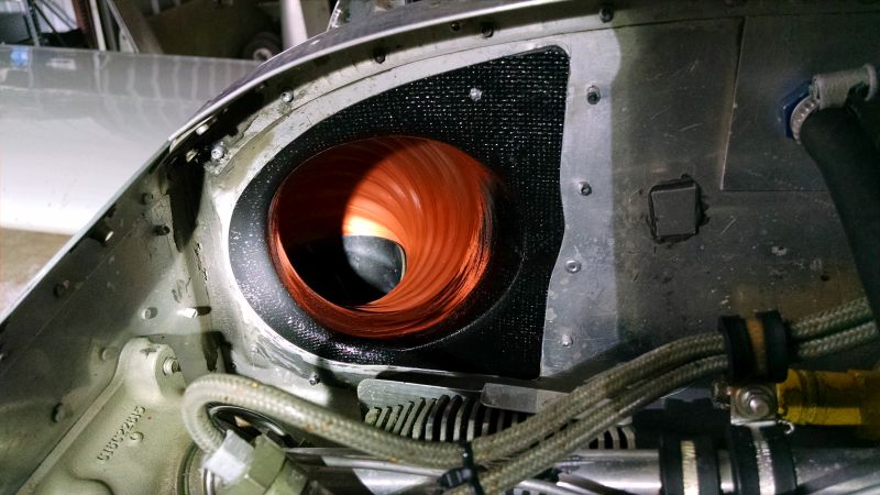

Dan, do you have a figure for the closed door exit area?
13" x 2.625" less about half the tailpipe area, ballpark 22-25 sq in. Right at the moment I don't remember the exact tailpipe diameter.
Postscript; measured the tailpipe..2.5" diameter, so (13 x 2.625) - (1.25^2 x 3.14) = 29.2 sq in. Call it 30.

Dan, what fuel flow are you at in th picture of your EFIS in post 190? I am trying to equate your 390 cubes to my 360 for the other parameters. Thanks.

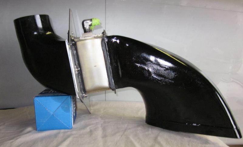

Since Allan has brought an OTS solution to market using a similar actuator, did you ever tear that thing apart to see if it was a pending failure or?

About 11.2; the EGT values are degrees ROP.
Dan, a question that is a little bit off the current topic but still of interest concerning the shrinking exit -- Have you evaluated the CHT's, TAS, fuel flow, Oil Temp, etc. while running in the same configuration as you posted in #190 while LOP? If so, what numbers have you seen LOP in that similar environment?
Not seriously. No point. The benefits/shortcomings of LOP operation are independent of exit area.
Understand about the exit area issues not really relevant for a conversation on LOP operations. I was just curious if you tested running LOP compared to ROP and what the delta was for the parameters mentioned.
Hope to talk with you again at OSH.
Dan, i am designing a cowl flap for summer ops. How is the RA servo holding up?
I am going to finish my flight test phase before starting all the press/temp measurements under the cowl. I have all the instrumentation ready. I wont make any FWF mods until I am instrumented.

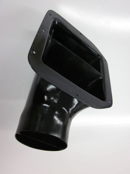

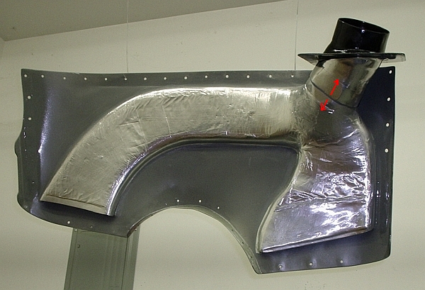

Started flying this oil cooler air supply duct in early 2013. The goal was to reduce the temperature of the air reaching the ducted oil cooler; measurements said the air picked up as much as 17F as it made its way from the cowl inlet to the rear baffle wall.
The duct dropped average oil termperature as expected, but I later decided to install a larger 10611 oil cooler anyway. I removed the above duct from the plenum lid at the most recent annual. As an experiment, it proved the theory, but isn't really needed now.
The 10611 with inlet and outlet ducting remains. Inlet is fed from the rear baffle wall. Cooler hangs on the motor mount. Inlet diffuser has a turning vane. The outlet duct sits flat against the firewall and terminates in the top of the cowl exit bell.
