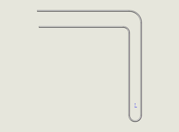

Pierre, imagine a piece of clear tubing oriented as in the drawing below. Fluid (water usually, I like adding food coloring to make it easier to see) is added such that the upward facing "U" portion of the tubing is half full up each leg. One end is routed to a point in the plenum, the other to one of the other locations Dan mentions (for example). Obviously, in order to see this in flight, the tubing has to penetrate the firewall somewhere. Also, the tubing has to be fastened to something (piece of wood, aluminum sheet, hard plastic, whatever) so it doesn't just flop around, and the U has to be oriented vertically as in the drawing, and you have to be able to see it while you are flying.
Without going into the nuts and bolts of the installation, now imagine flying with this. If there is a pressure differential at the points of interest, then one leg of the fluid is exposed to a higher pressure than the other, and so the fluid columns in each leg will be at different heights. The difference in height is the pressure difference. Assuming you use water, the difference would typically be denoted in inches (or millimeters if you prefer) of water.
Note that it's good to have an idea of what pressure differential you might expect to see prior to setting this up. If the differential is greater than the water column height, you can wind up sucking the water out of the manometer.
I've been mulling it over and fits what I thought..thanks.

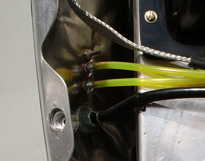

Looked at digital manometers, but I'm really cheap....had lots of vinyl tube and a yardstick.
You can't spill water in the cabin....the ends of the tubes are in the engine compartment.
The yardstick sits upright in the right passenger footwell of the RV8, taped to the canopy rail. No problem, so surely there is enough room in an RV10.
I made miniature "firewall fittings" by chucking some 3/16" all-thread rod in the lathe, drilling the center, and removing the threads from each end of a 2" length. Use an AN3 check nut on each side of the firewall:
The yellow tubing is tygon, sold as "small engine fuel line" at the NAPA store. Tygon handles engine compartment heat a little better than vinyl.
As I recall, Tom Martin ran his manometer tubes through the heater box.
FWIW, I also installed six "blank" wires in the wiring bundle through the firewall back when I was rigging the engine. They can be used for any experimental purpose. Right now they are hooked to temperature probes.

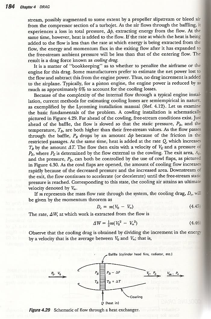

A serious question, so I dug around on my shelf for a reputable one-page reference. This from Aerodynamics, Aeronautics, and Flight Mechanics, Barnes McCormick...the fundamentals:
Eq 4.45 spells out the most basic concept...mass x momentum loss = cooling drag.
Note the concept in the first paragraph about energy removed and energy added.
For any given power setting the quantity of heat you must carry away is fixed. The best way to decrease required mass flow is to increase the quantity of heat transfered to the mass, ie heat the air as much as possible during its pass through the engine compartment. Doing so requires less mass to carry away the same quantity of heat. Measuring the air temperature increase following a pass through the system (or an individual cylinder baffle, or an oil cooler) is one very real yardstick for cooling efficiency. Heat exchanger efficiency = cooling air temp rise / (CHT-OAT)

Cooling drag is analyzed as a momentum loss across the system. The "system" is composed of an inlet; a heat exchanger; and an exit:
Flow conditions are denoted in the schematic. Ahead of the inlet plenum, we have free stream pressure and velocity: P0 and V0. At the heat exchanger interface, there will be (most likely) a temperature rise and pressure increase: Pb and Tb. Heat is added by the exchanger: Q in. Flow across the cooler interface will lose pressure due to friction loss through the cooling fins. At the back side of the cooler, we thus have an incremental loss of pressure and an increase in temp in the flow: Pb-dP and Tb+dT. The "dP" and "dT" represent delta-P and delta-T across the cooler. At the duct exit, we have velocity Ve and pressure Pe which will vary with duct design and exit area. Down stream of the exit, we once again reach free stream conditions: Vinf and P0 (free stream velocity and static pressure).
The hard part in sizing the cooling duct system is knowing the flow conditions at the cooler face Pb and Tb, and knowing how much heat is added to the flow and how much pressure is lost across the cooler. But these can be measured with a little work.
The mass flow through the system can be found when we know the density of the flow, its pressure, and the area across the cooler. More mass flow equals more cooling. The total drag of the system can be found using compressible flow analysis (momentum loss). Inlet and outlet sizes can be optimized for the mass flow needed.

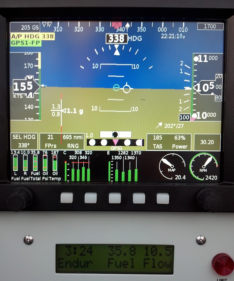

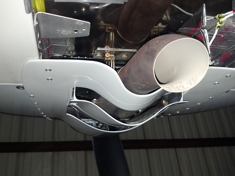

Got in a flight today to check the new cooler exit duct. Low layers and an overcast at 5000 so I was a bit limited; I'll get more Tuesday when I fly to an auction in Chattanooga.
Looks like an incremental improvement, as expected. I climbed out of Wetumpka at 110 knots to 5000 then dived into Alex City for cheap fuel (note to self: $4.75 is cheap...keep repeating, $4.75 is cheap..). I just wanted to get everything hot. The real test was a departure at 185F oil temp on the runway before going forward with the throttle. A 110 knot climb from 600 had the oil temp stabilized at 205F at 5000 with OAT at 79F. It came right back to 185 when level.
OSH in two weeks....I dropped down to 1500 and dragged the 20 miles back to Wetumpka at 80 knots, just like the Ripon approach. Prop forward and 1950-2000 RPM did the trick; oil temp stabilized at 195F about 5 miles out. Yep, we're ready!
Next experiment.

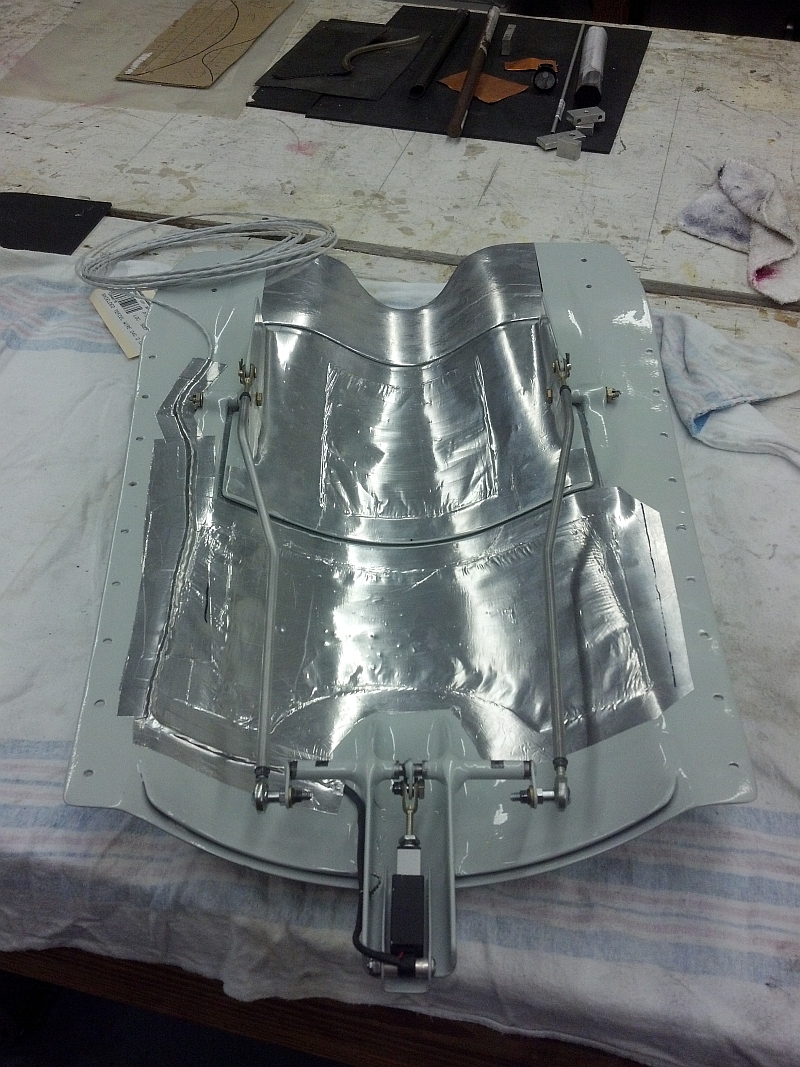

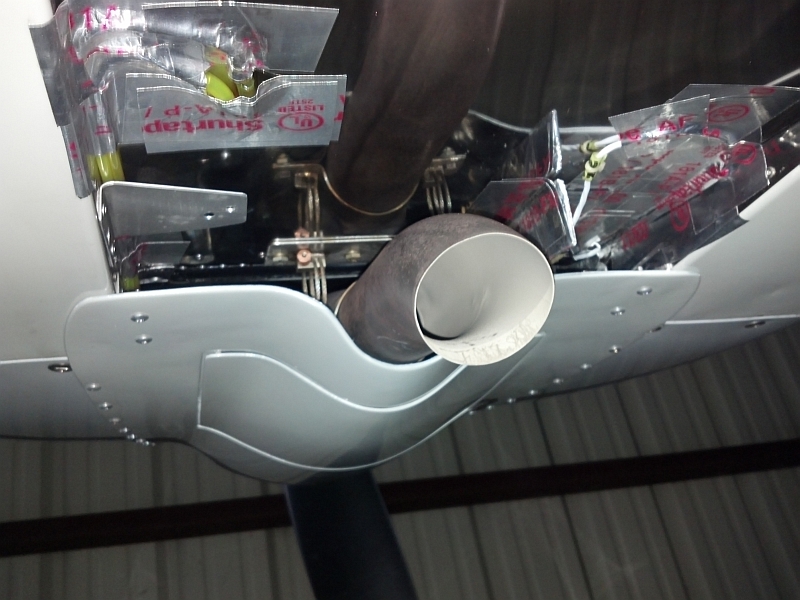

Cyl #3 has always been about 25F warmer than the coldest cylinder. I figure it's mostly a case of lower local pressure in the right rear corner of the plenum; there's a 4" hole back there to feed the oil cooler. Take a look at the pressure maps in CR3405.
In addition, the oil cooler air supply temperature has risen 15-20F (compared to OAT) by the time it gets to the oil cooler face. No big surprise; the air passes lots of hot cylinder fins in the upper plenum on its trip to the cooler inlet duct.
We all know what a difference 15-20 degrees reduction in OAT can make, so I started thinking about how to get some unheated air back there for cyl #3 and the oil cooler supply. I'm going to try separating the air into two parallel paths. One is conventional (the usual movement inside the plenum enclosure). The other is via a new duct attached to the underside of the plenum roof. The duct does not extend all the way to the rear plenum wall, but rather just to the rear edge of the #3 fins.
The goal is to deliver cool air, so the duct is insulated by laminating a sheet of ordinary 1/16" fiberfrax felt into the surface. I did not want the fiberfrax to soak up resin, as that would both make it heavy and defeat some of its insulation properties. So, to stick it in place I laid a thin coat of micro on the duct surface, then pressed the felt into it. It then got a cover sheet of very light crowfoot glass.
Working on my annual now and hope to be back in the air in another week or so. The goal is to maintain low oil temperature while running the very smallest exit at 100F OAT. I may not have any more really hot test days until next spring, but you never can tell about fall weather in south Alabama.

The above experiment to direct cold air to the area of the oil cooler duct entrance reduced air temperature at the oil cooler face by about 10 degrees F, with the expected effect on oil temperature.
There was no attempt to seal out hot plenum air. No point; the single duct only had a cross section area of about 7 sg in, not large enough to supply all the required air. So next experiment; let's take all the oil cooler air from just inside the cowl inlets, and send it to the cooler with a sealed system.

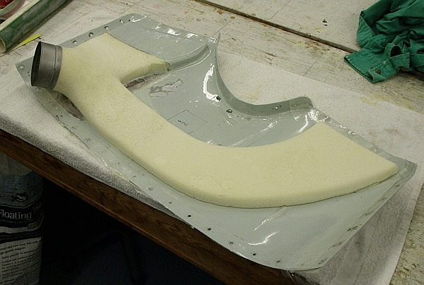

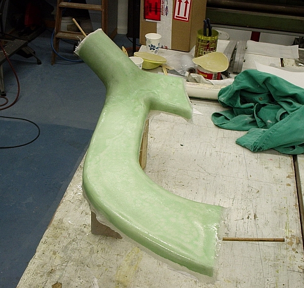

Recently in another thread I wrote about converting to two-part urethane for many of my mold and forming tasks. Here's a pretty good example; a few minutes with some paper and tape for dams, mix, pour, and a half hour later start carving and sanding. This form would have been very difficult with clay or block foam.
Should be flying again in a week or so.

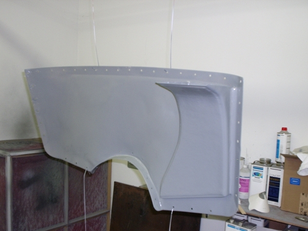

Dan, how much space between the duct and top of cyl fins? Any thought to insulating the duct? ooking forward to your results.
About 1-1/2" ~ 2" at the intakes and more towards the rear. I'll insulate like the previous duct.

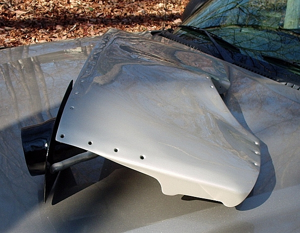

Air flowing through the cooler when the vernatherm is open is just drag, so flow control is smart. Others are doing it with a butterfly or a shutter.

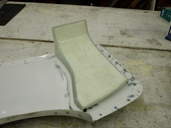

Ok, done, off to the airport. The black section with the flange gets riveted into the rear baffle wall. A slip fit (at the arrows) allows plenum lid removal. The duct is insulated with 1/16" fiberfrax and Vans stick-on aluminum reflector material.

Very interested in your results. what area ratio did you use from duct inlet to entrance to the rear baffle slip joint? Were the two duct inlets of equal area or did you try to balance based on CHT deltas in flight?
are you planning a full pressure survey of the ducting as well?
what area ratio did you use from duct inlet to entrance to the rear baffle slip joint? Were the two duct inlets of equal area or did you try to balance based on CHT deltas in flight? are you planning a full pressure survey of the ducting as well?
The design approach is entirely TLAR. I did try to make the area total equal the 4" SCEET down to the cooler, a little over 12 sq in. I recorded some pressures previously, so I'll no doubt make a comparison.

Bob, My hangar mate just made a very nice plenum top by molding it up to the top of his Van's cowl (RV-7). This will yield a shape that fits right under the cowl line and will maximize the plenum volume.
You could lay it up inside the cowl, but because of the bowl shape, you will get epoxy pooling in the center low spot and this would be a pain to deal with.
Obviously the trick is protecting your cowl from epoxy. We used packing tape and sandwiched the glass and epoxy betweem sheets of release plastic (maybe Visqueen will work).
This plenum top was then mated to Van's stock baffles. Came out nice.
He is now working on mating the stock Van's inlets to this plenum. We are using a "snorkel" kind of idea to get complete sealing between the inlets and and the plenum.
The "snorkels" were laid up "female" inside the stock openings. As the cowls are taken off, the snorkels will remain attached to the plenum via neoprene boots.
I think it will be pretty slick.

Exit panel Ver.4 got its shakedown cruise last night. This one extends 4" further aft than previous, meaning 4" aft of the firewall. The slope in the RV-8's inset exhaust ramp means the primary exit is again progressively smaller than previous exit panels.....
....possible because this one incorporates additional exit area on demand.
The door is hinged just forward of its center, so the forward edge raises up into the cowl as it opens. The result is two additional exit areas with the frontal area addition of one. Having eliminated the entire exit chute from the bottom of the RV-8's cowl there just wasn't much virtue in frontal area addition, even in slow speed operation.
The center-hinged door also reduces mechanical loads on the operating mechanism, a linear actuator with a linkage rigged to be over-center when the door is closed.
Ok, preliminary data, a shakedown cruise. I launched with the door open and climbed from 200 feet to 10,500, WOT, 2700 RPM, leaning in the climb, at 105 knots indicated, arriving with oil temperature on 197F and CHTs of 347, 330, 355, and 334. OAT was 70F on the ground and 49F at 10,500.
Pushed over and established the usual settings for fast cruise, WOT, set RPM, lean to 100-125 ROP for best power, trim, altitude hold on. Indicated TAS settled in at the usual 181 knots, more or less, which is what I had with the previous shorter exit.
Now the good part.....thumbed the switch to close the door, and picked up four knots....
Me like.
Dan, congratulations on this new setup, Expiremental aviation at its best:D
Bob A.----you watching this one???
Drag
Man, that is pretty.
Hard to believe there was any drag to wring out of that configuration let alone 4kts.
Looking forward to seeing your data. I won't be surprise if someone buys the rights. Great R&D work.
"... a linear actuator with a linkage rigged to be over-center when the door is closed."
Cool stuff.. Minor detail: if it's truly over center, that means it would be jammed, right? I'm confused on why you describe it this way.
