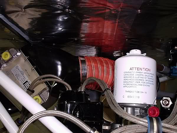

Oil Cooling
I have the inside of the cowl divided into three compartments - #1 is the area above the cylinders, #2 is the area under the cylinders leading back to the stock cowl outlet, #3 is the area above the lower cowl outboard of the plenum baffling & valve covers continuing back to the area between the engine and firewall with a vent in the upper part of the stock outlet but separate from the exit path out of #2. In race configuration I mount closure plates over all of the blast tube and heater ports at the rear of the plenum but the oil cooler continues to pass all of its cooling air into the large #3 compartment where it is vented through the small opening below the fuselage in the stock cowl cooling air port.
The small zone #3 cooling air port is provided by continuing the curved baffle dividing compartments #2 and #3 down below the fuselage in the stock cooling air outlet and securing with screws to the flange of the fuselage skin and firewall. The size of the opening ground adjustable and is controlled with AN960 washers stacked at the mounting points. The vent is approximately 3/16" tall and 7" wide. The oil temperature is stable at ~180 degrees under all conditions. I experimented with opening the vent to 1/4" and detected a slight decrease in speed with no noticeable change in oil temperature. I see no need for a separate inlet for oil cooling in my O-360 application.

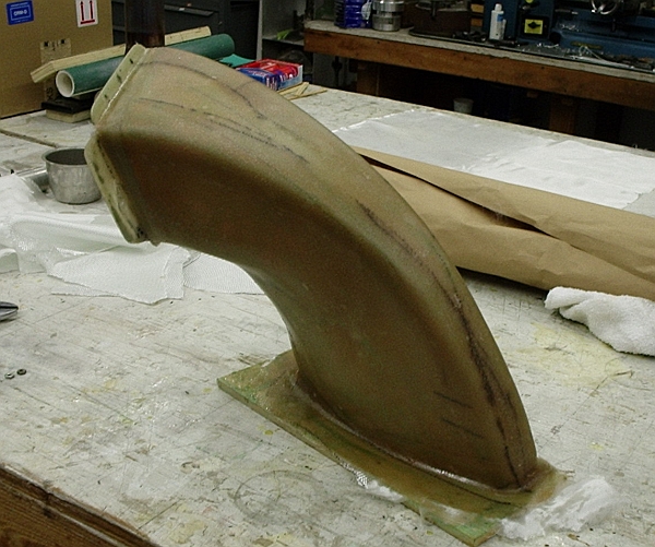

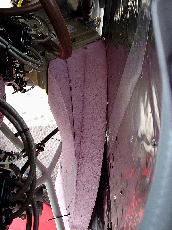

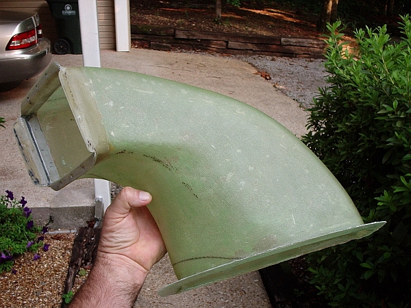

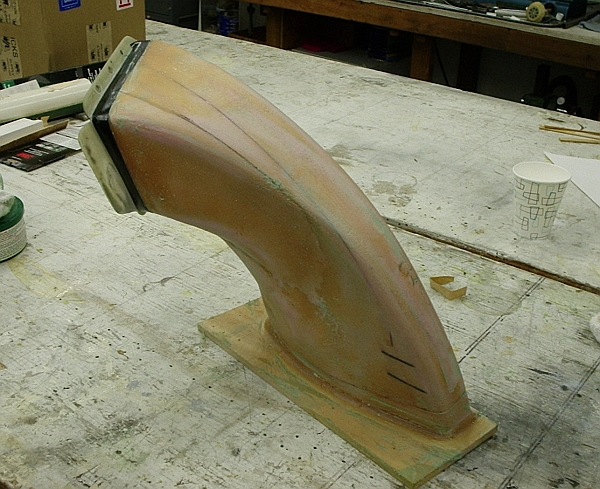

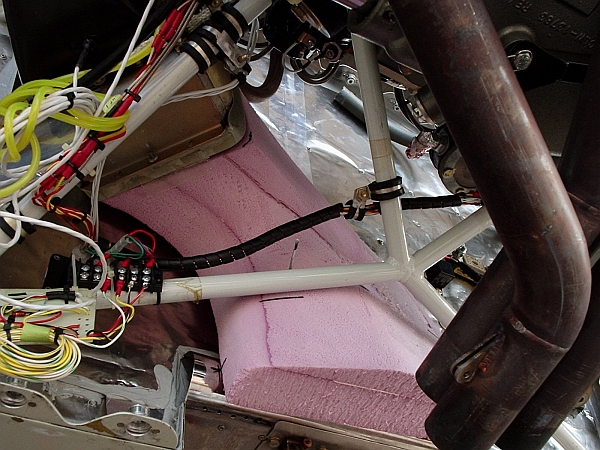

With the store closed for the 4th I had some time to build a new cooler exit duct. The original was two fiberglass transitions and a 4" SCEET hose, and I suspect rather restrictive:
So, start by shaping foam:
Prep it and do the layups:
Then remove the foam...rough duct ready for some sanding and general cleanup:
Hopefully back in the air by next weekend for test. I may need something similar for the entry duct from the plenum. Even SCEET (lined hose) is pretty bumpy on the inside ;)

I also have a remote SW oil cooler with 4" scat duct from #4 aft baffle. It does not have the nice exit flow device as per Dan, but simply dumps its air into the lower engine area just above the exit. I've flown twice this past week with the OAT in the low 90's and oil temp ran at 168F!
I believe it. Understand why I need the exit duct and you don't...my lower cowl volume is pressurized, while yours is near static due to the huge exit area. I must duct to low pressure at the cowl exit.

I'd like to build an exit duct for my -10's oil cooler as well. In case you don't know, they're mounted on a firewall box that's angled about 30 deg downward, with the air coming in the top.
How do I determine the exit area? The cooler is fed by a 4" duct off the back of # 6 cylinder.
I'm not so sure you can accurately calculate the exit area for a particular mass flow. Pressure differential drives flow, friction reduces flow. There are equations for a theoretical perfect duct.....but we build imperfect things. It's hard (for me anyway) to define the friction due to the duct wall, bends, etc. Maybe one of the bright guys can chime in here?
The one I built this weekend is more-or-less a constant section area equal to the cooler face area, roughly 25 sq in. The previous setup took the cooler outflow and squeezed it back into a 4" tube (12.5 sq in), ran it around a right angle bend with a bumpy minor radius, then into another fiberglass transition whose outlet was partially blocked by the exhaust pipe. Surely the new one will flow more.
