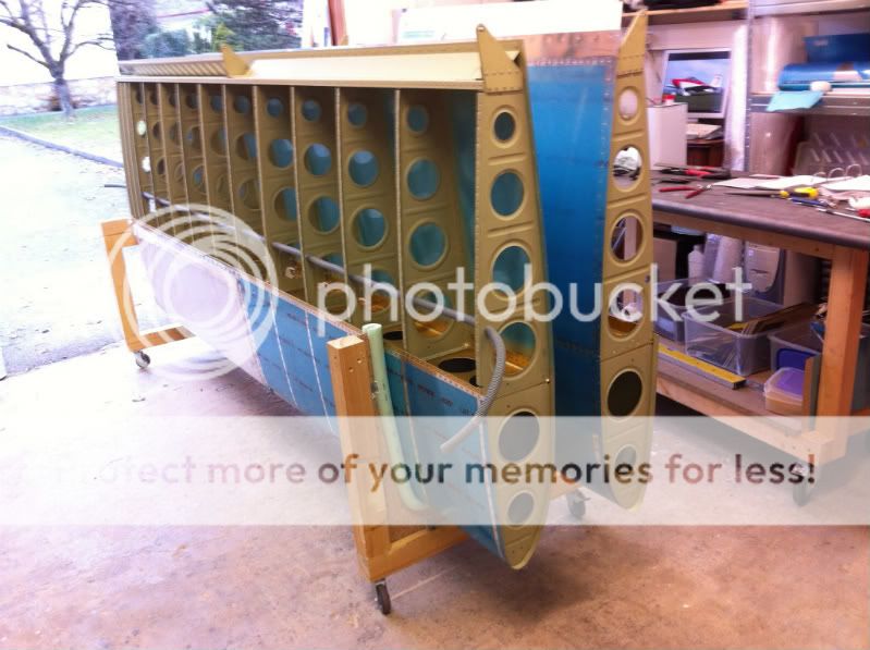

Wings in cradle
Both wings are now in the cradle, almost done except for the bottom skins. I have to wait for the French Inspector to see the inside of the wings before being allowed to close them.
Next step: ailerons and flaps, Dynon pitot, Dynon roll servo. Starting on that next week.
It's all been good fun so far :)

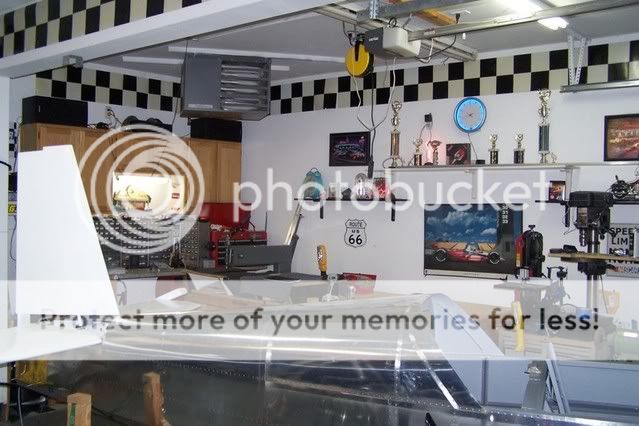

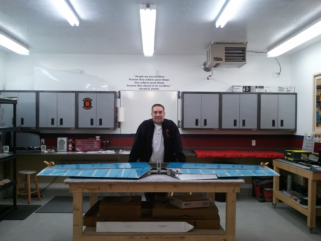

After nearly a year since receiving the kits, my Slow Build Empennage is complete sans glass.
Now on to the Wings!
Love your work shop!
But:
It's to bright, need sun glasses.
It's too clean! Where's all the stuff on the floor?
It's over organized. WOW
It's not like mine :(
Seriously, Keep it that way and you will do well.

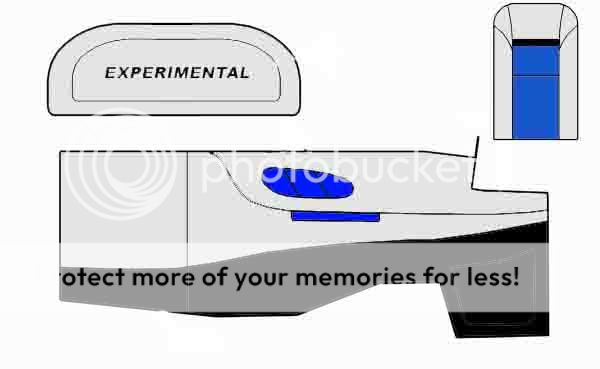

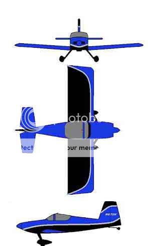

Even though I haven't touched the RV in 10 months now I have made alot of progress. All the big ticket items have been ordered, all that's left is to finish assembly I guess. Sounds easy :)
Also we picked out the final paint scheme and Interior yesterday. Interior will be ordered in the next few weeks.
What do you think?

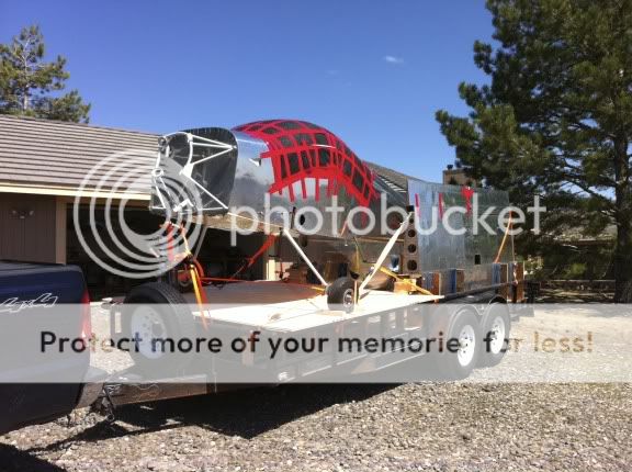

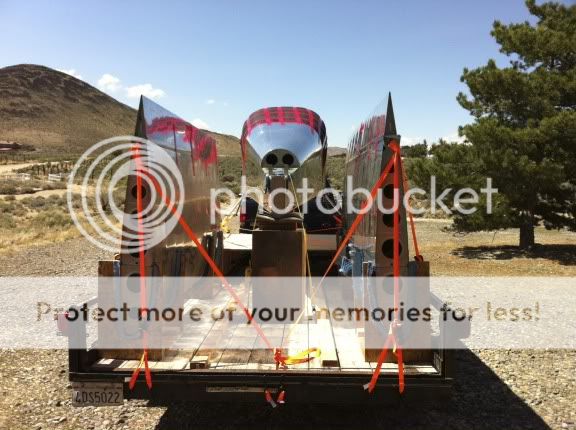

So last thurs on the 30th I got a call from my wife telling me "Its here, It's here!!" And so it was, the empennage: My march Christmas present.:)
Now number one I can't believe what's in the boxes is +6 -3 G rated after I get through with it. Maybe it will be +1 -.5 after I am through...
So I am working diligently and one week and one day later I have a horizontal stabilizer and a vertical stabilizer!! So I have to ask since it varies SOOO much...
How am I doing on time? If y'all come back with "you should be done in 3 years at that pace" I'm just going to cry... I like the build BUT I wanna fly!!
My daughter seems to be saying "Look and what my daddy can build! All I thought he could do is sandwiches..."
Oh and by the way Van's called and they seem to have an extra QB wings and fuselage sitting around collecting dust!
"Well sure I will take it Anne!" I thought I was going to have to wait 60 days for the QB.
So before I even started my empennage some nice Philippino was whipping my fuse and wings into place!
Tony Partain is already set up to bring it to me no crate included. Whew....

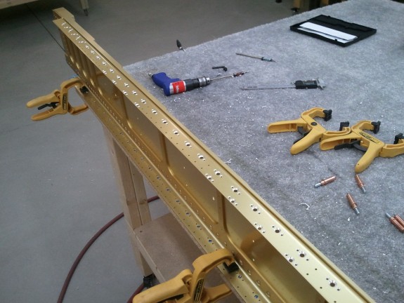

I started the Wings this week.
Glad there are guys ahead of me so I can learn from them!
Right behind you Jason! I got my SB wing and fuselage kits inventoried, and the right spar is on the bench, planning on making some chips this evening (too bad the spars can't be used in their full anodized glory...). I noticed you don't seem to be using the nutplates to pilot the countersink as the instructions suggest. I don't care much for that idea either, and plan to make a pilot hole jig (like Sam B's below) out of some thick stock from my scrap bin.
Yup, I used Rudi's method of a long piece of 1/16" aluminum angle that I used on the rudder TE. Worked like a charm. Got both spars sunk quickly and chatter free. I hope to have the Nutplates on Saturday after spot priming all the holes.

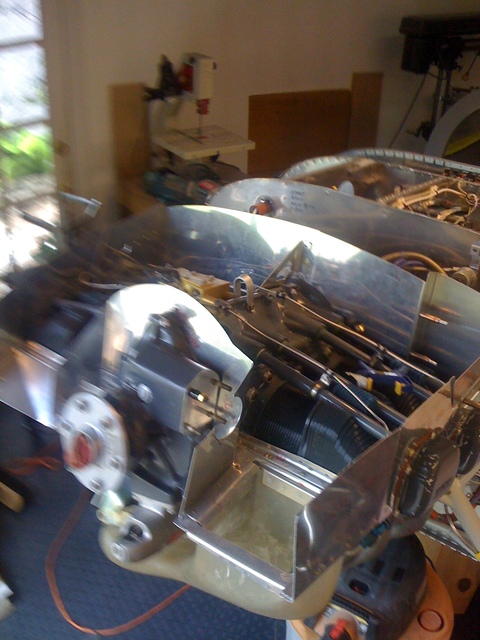

Drive a stake through its evil heart -Baffles.
Or, How I Got My Mojo Back.
I spent the weekend locked in mortal combat with the baffles. Since I'm here to write about it, you can assume I won.
I was able to get over the hump of fitting the front baffles with my weird front-governor configuration, and have progressed to trimming the tops of the baffles to conform to the top cowl.
I've still got a ways to go, but the current state of things is this:
Details are here:
http://stjohn.openbar.com/airplane/?p=860
Always cut off less than you think you should. You can always cut off more.

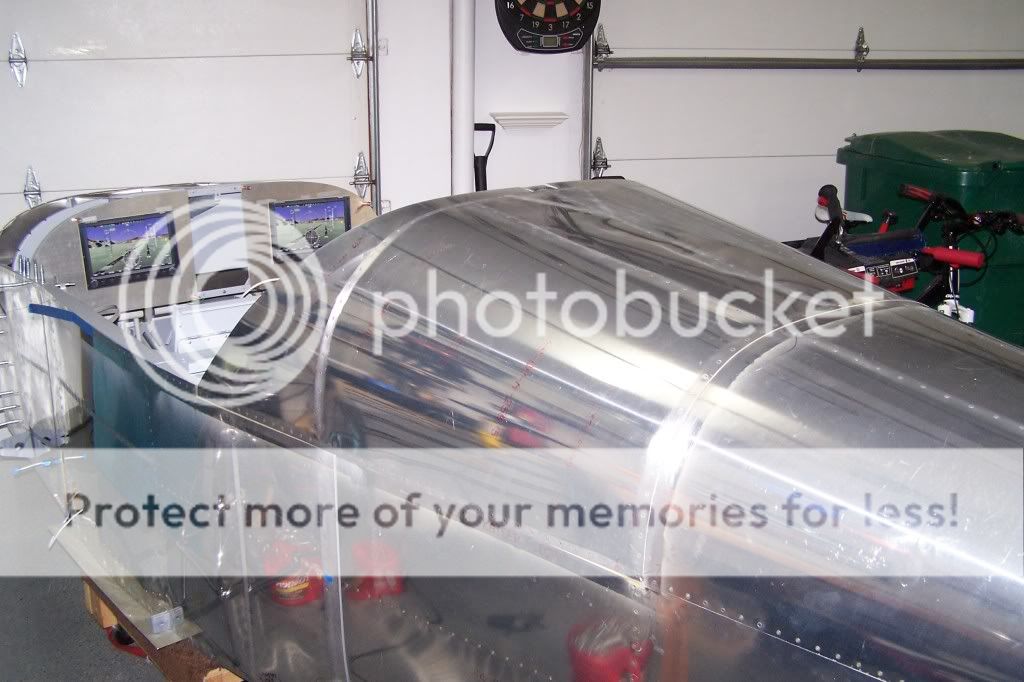

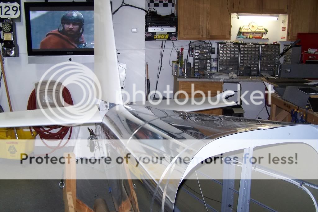

Ok so I am actually a little ashamed of my slow progress....I am at 2600+/_hrs on a QB RV-7A. :(:( with a projected 5/600 hours to go.
I can't say exactly why it has gone so slowly but I know that I am quite methodical and meticulous - OCD actually and sometimes spend twice as much time in research and understanding each step than I do actually doing it! I just can't shake this feeling of guilt and shame at taking so long when friends and builders around me have built slow build 7's in less time! Anyways, all I can do is what I do and look forward to the final day's work like you can not believe.
I am at approximately 85% completed and am currently working on the front deck structure and canopy frame and then the dreaded canopy. Here's my most recent progress as posted in the panel thread.....
and how she is looking overall...
