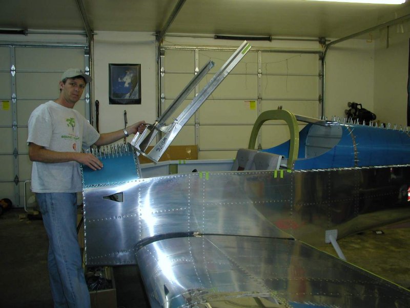

Here is a picture of my RV-7A. First flight in February. Paint by Bobby Potts in Tuscaloosa, AL. I highly recommend Bobby and his group. The price was reasonable and he took my shabby fiberglass work and made it look beautiful.

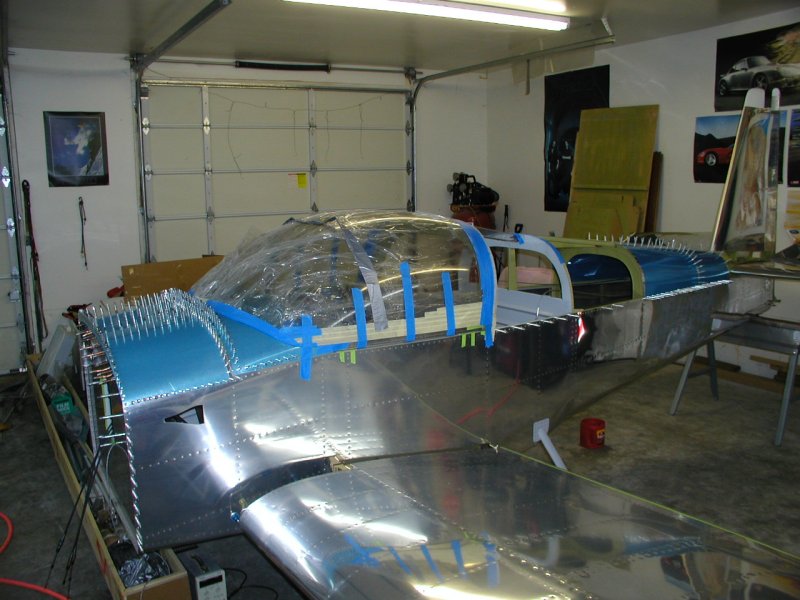

Sometimes you gotta stop looking at it and just do it. Today was that day, even though it was only 7am.:)
Sometimes you gotta stop looking at it and just do it....couldnt agree more.
Today started like this.....
[/URL][/IMG]
and ended like this.....
[/URL][/IMG]
Mick and I were focused today and 5 hours later the cowls were cut and fitted (with clecos).
Hard to explain but when you get your cowls on it looks like the real deal and you feel like you are almost there......even though you know you are not !
Looking forward to tomorrow.

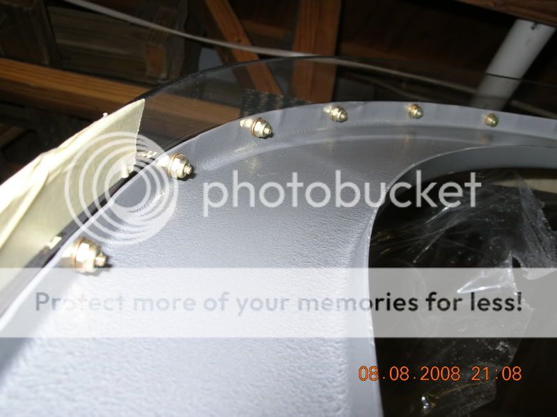

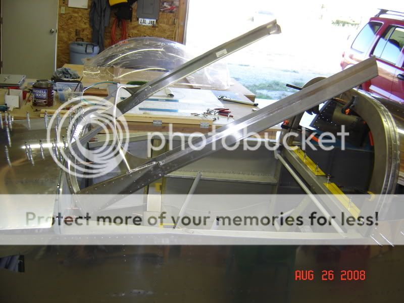

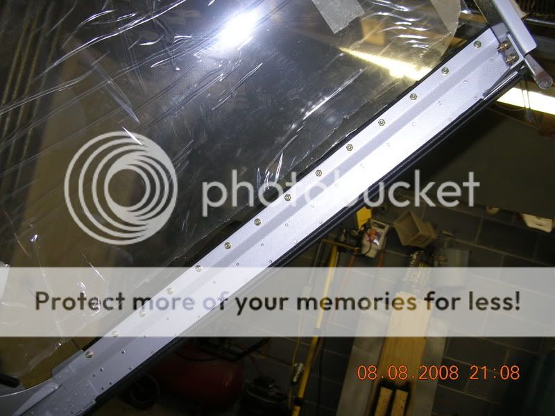

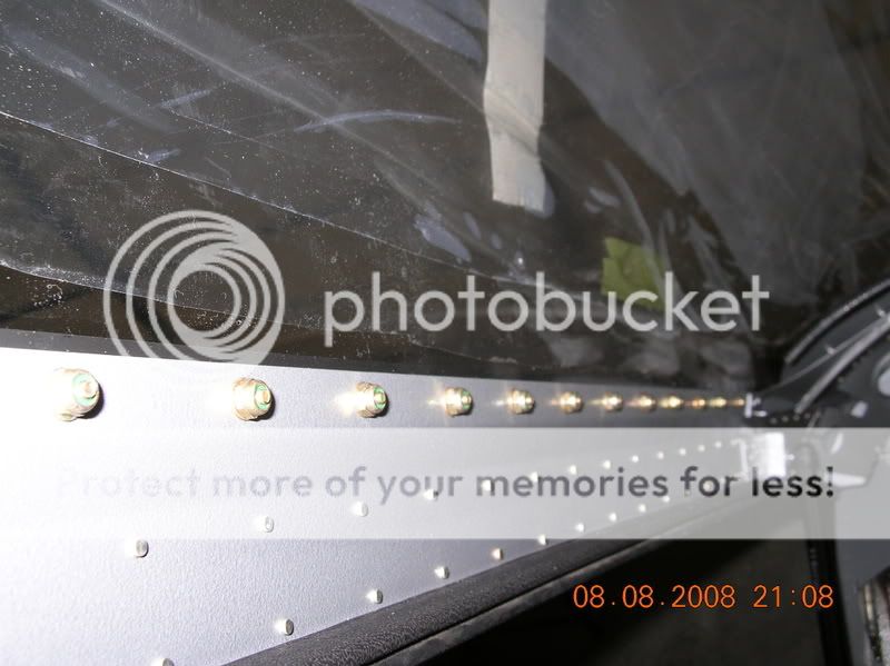

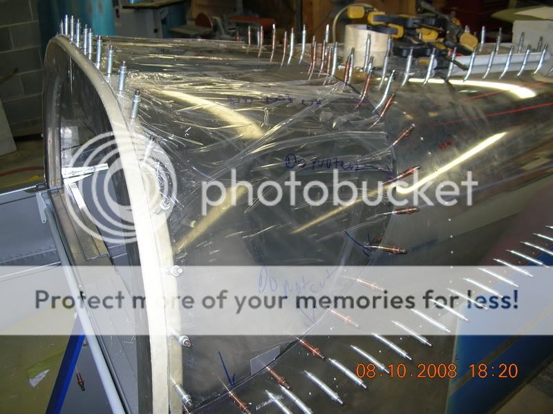

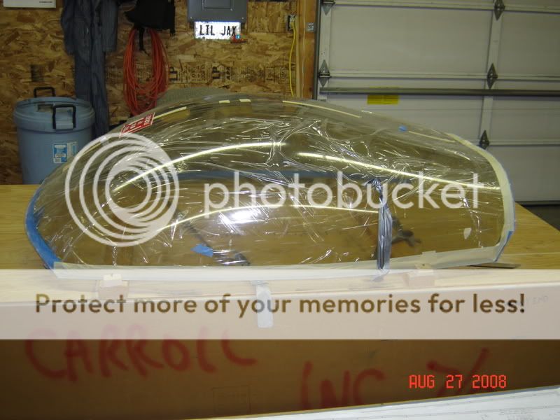

Got several things done on the canopy this weekend.

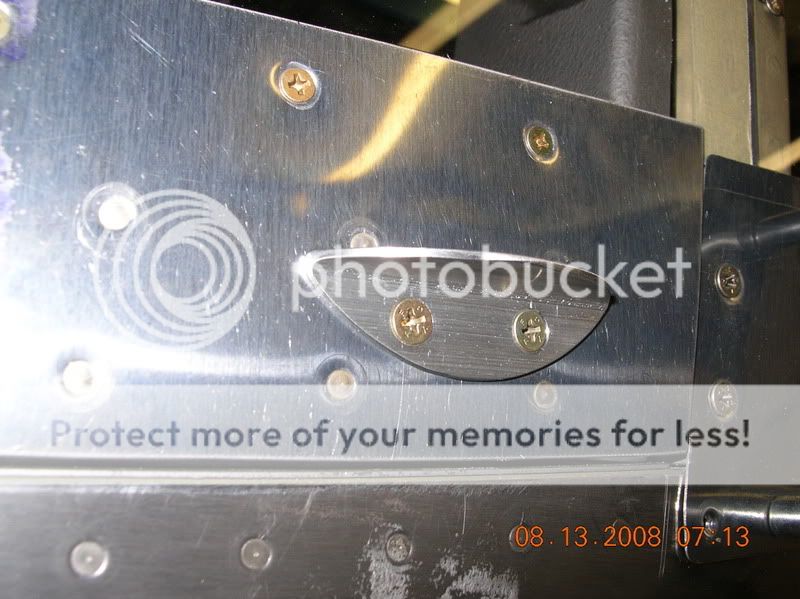

Installed the rear latch fingers, do yourself a favor and just remove the rollbar to make this a no stress event. I started not to but decided what the heck and it took all the stress out of this job:

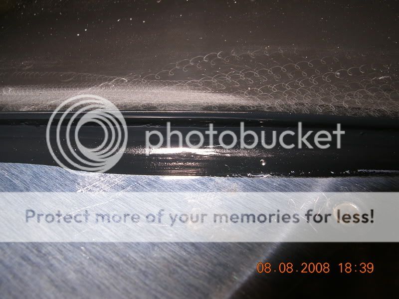

I glued the front of my canopy down to the canopy skin with some black urethane window sealant from Autozone. I did this to give the front of the canopy a perfectly consistent surface to support itself on. After riveting and screwing the glass to the frame, I had some gaps under the plexi in the front. I just calked this stuff from the outside and then took my finger and made a fillet. On the inside I got a nice rolled bead all around where the plexi meets the skin. Really made it look finished from the inside. Next is the flox then the glass in this area.
Finished all the screws all around the frame. I kinda like the techi look of the hardware contrasting with the paint.
Installed the rear safety latch/handle. This was super easy to do and it works great.
Trimmed, fit, edge finished, drilled, countersunk, drilled and tapped the rollbar and temp. attached the rear window. Have a little more sanding to open up the gap between the front and rear so it will close all the way but for the most part, all the plexi cutting is officially done! So far no cracks!
Also got my carb in the mail that I bought from another RV'er all the way in Washington state.

Status Brantel

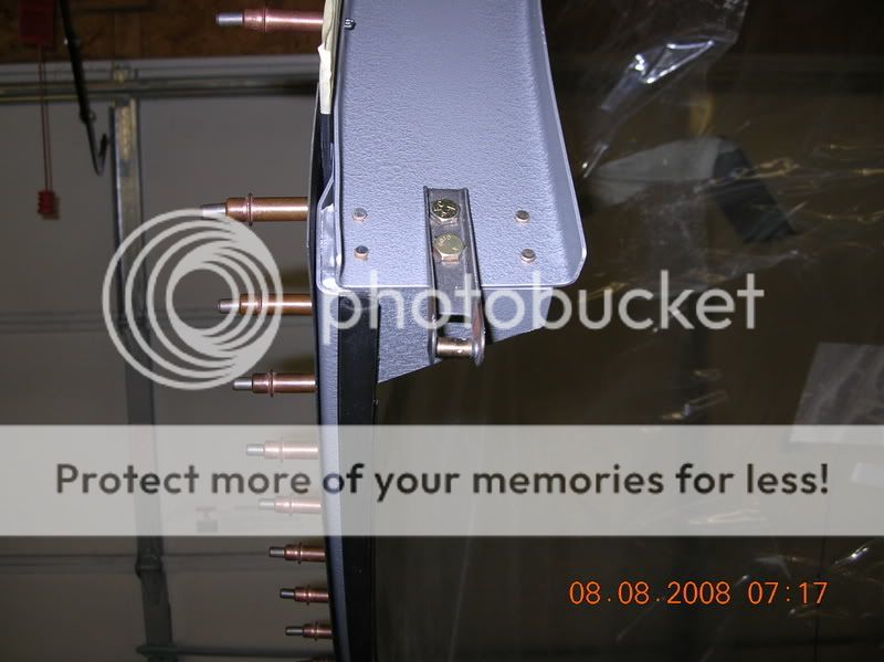

This canopy work seems to take forever. I think I have more time in this so far than I had in both fuel tanks. Nothing too hard, just time consuming! And I have not even done the fiberglass in front yet:eek:
I will call everything done except the front fairing and maybe a targa strip. I do not want to perm. mount the rear window yet so that will wait. I still need to paint the rollbar and the rollbar to bulkhead brace and the underside of the aft top skin. I am waiting to rivet the aft top skin on for a little longer.

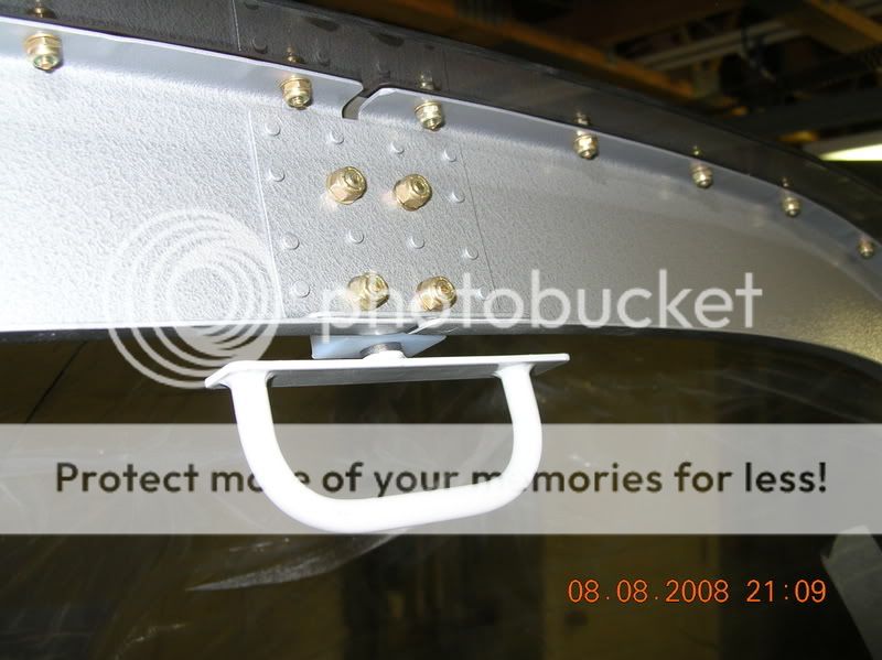

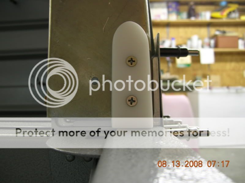

I installed a handle mostly copied from Jeff... Thanks Jeff!
I did not put one on the co-pilot side because several people warned me that that is asking for trouble and for the most part I would rather be the one doing the opening and closing.

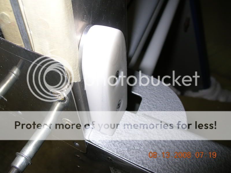

I also added these Delrin guides very similar to Jeff's....Thanks Jeff!
On the co-pilot side for whatever reason I had to add a shim behind it because it was comming up a little short in thickness and it was possible for the latch finger to sit on top/front of it instead of slide down the side like it is suppose to. Once I added this spacer, there is no way to get the finger to catch on the top/front.
These things really seem like they will do a good job to help protect the corners of the plexi and the paint around the latch finger holes and to stop paint from being scraped off the rollbar.
Jeff says that there is no way that you could damage the interface areas with these. Well almost, if you really were not paying attention to what you were doing, you could still do some damage but not nearly as easy as if you did not have these guides.
Everyone says the whole thing will stiffen up more once the fiberglass is on.... we shall see:D

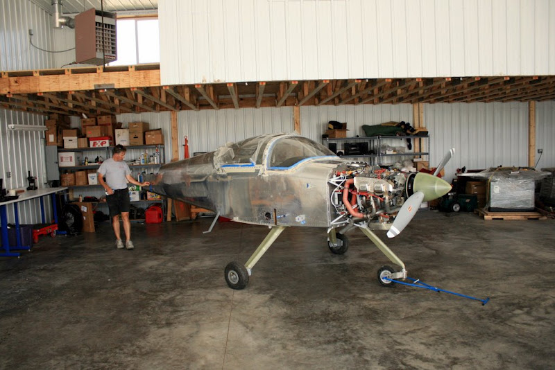

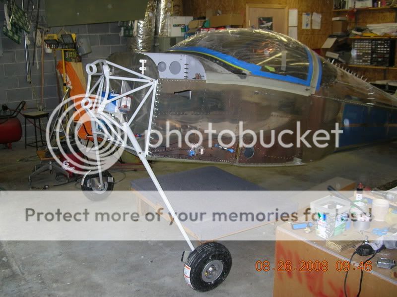

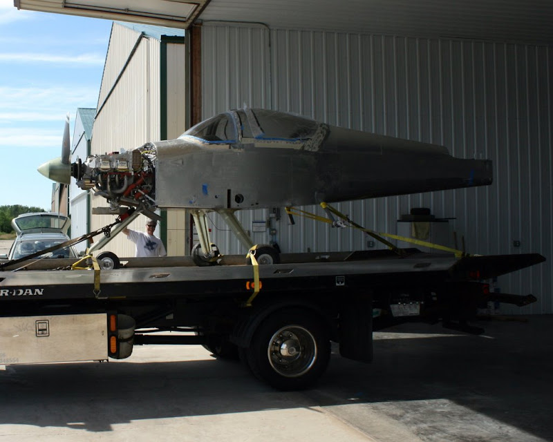

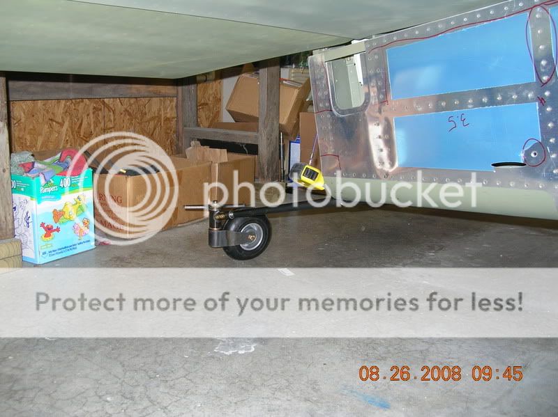

Status Brantel On the Gear and Rolling!
Engine mount hung, on the gear and rolling! Ready for that engine!
This may have to go in favor of a better one but for now it is on there!

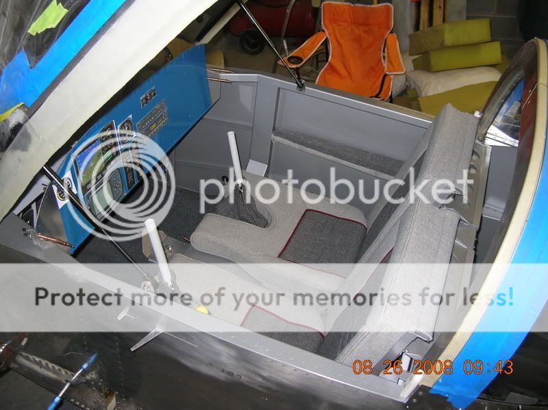

and to see if I could still open the canopy enough to get in, a nice shot of the interior. The end result is that it does not open all the way but almost! I can still get in/out no problem.
canopy next

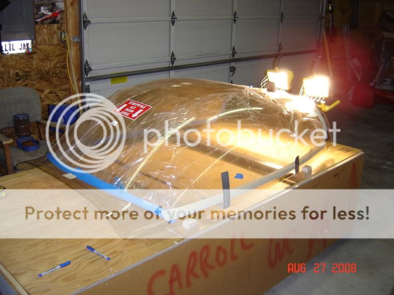

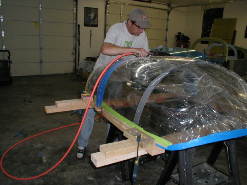

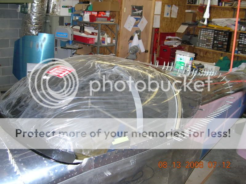

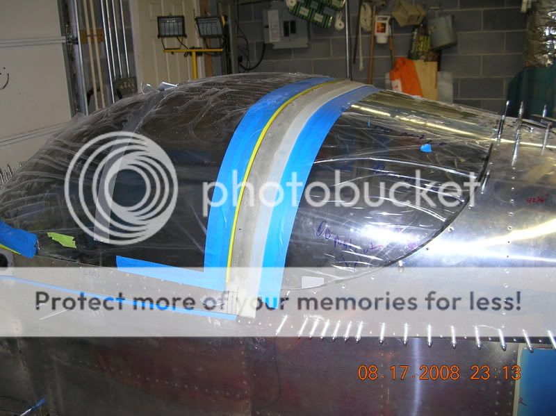

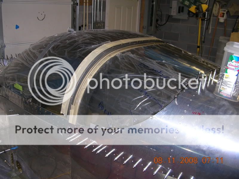

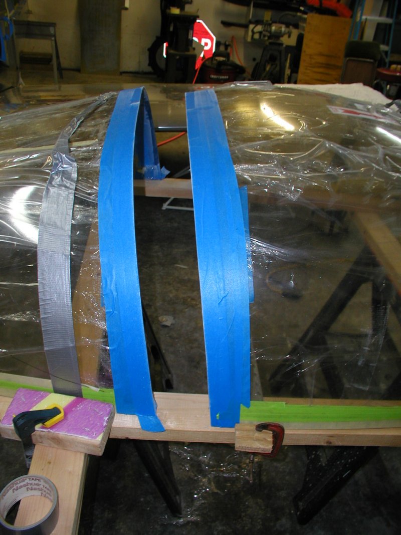

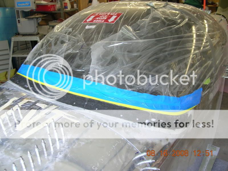

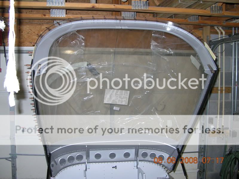

Tip-up frame is ready and I have no choice but it's time to tackle the canopy. I've read a few hours of posts and blogs, but welcome any words of wisdom regarding this process.
now if the clouds would go away, I won't have to start the wood stove to heat the shop.
EDIT: No need for the clouds and rain to go away. Just grab your double halogen shop lights and heat that baby up.
63*F in the shop this morning. 86*F under the canopy when I started and 105 when I finished. I would say "no sweat" but that would be false. 100*F+fatguy=plenty of sweat, but worth it.
used Vans supplied cutting disc in my Mac air drill. running it slow worked best for me. no problemo
